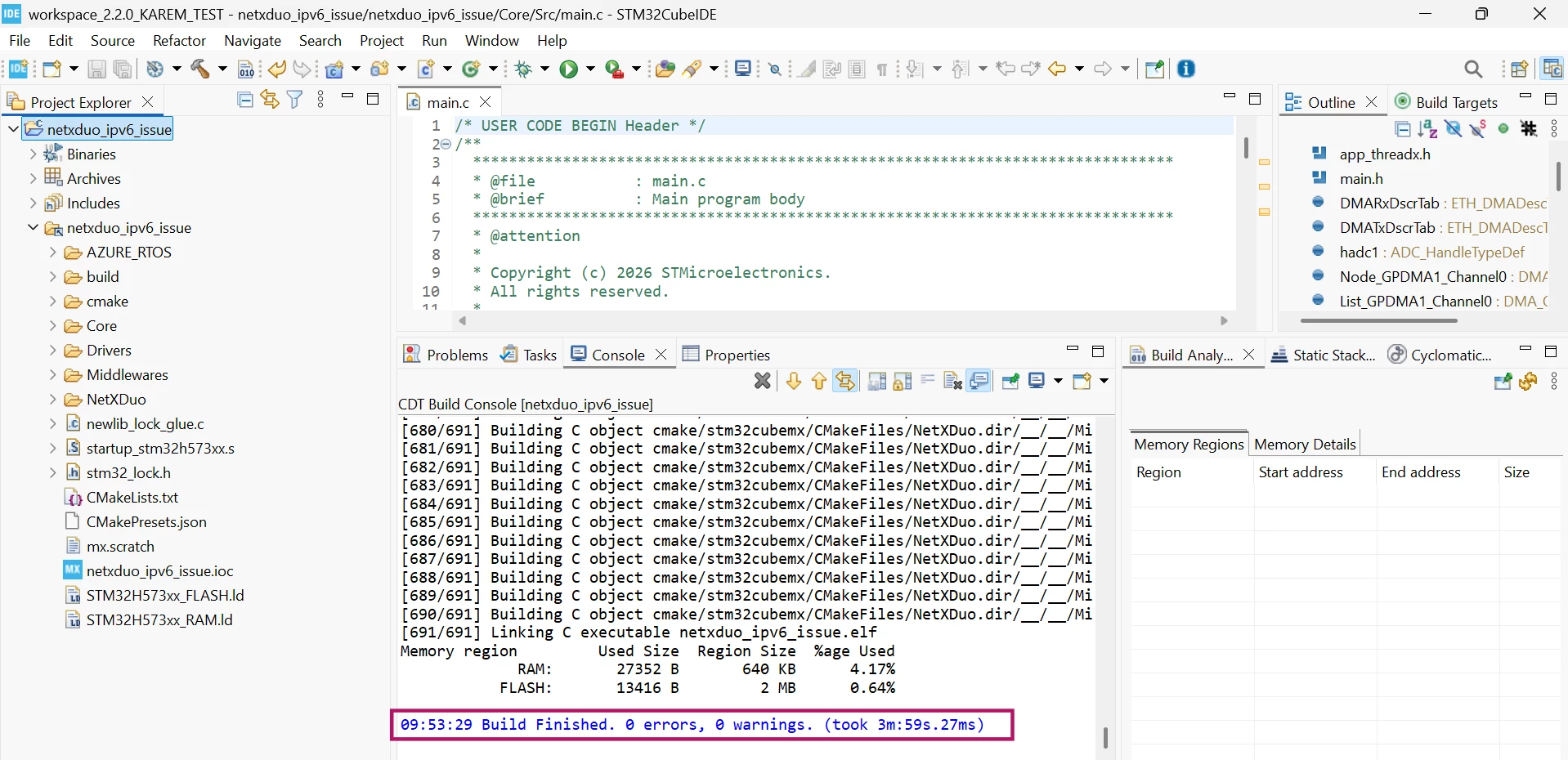

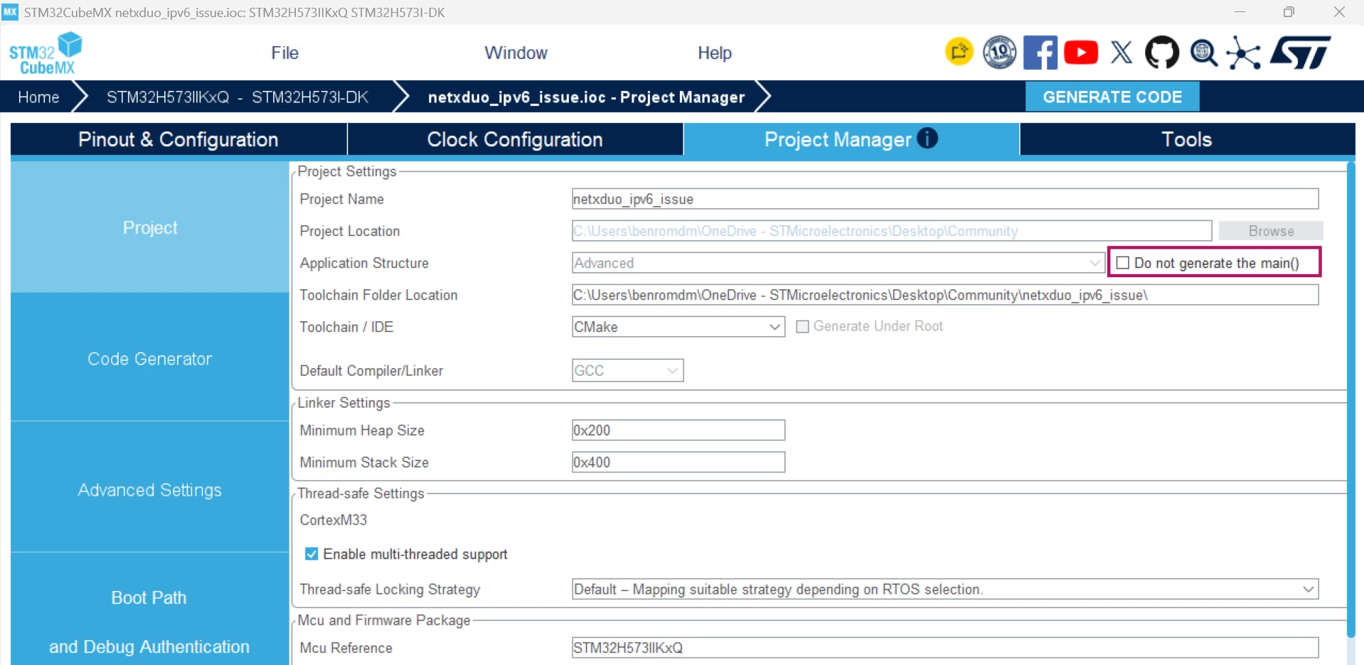

Oct 7, 2026 8:59 AM UTC
Hello ​@sergiosanri
After investigation, you need to disable [do not generate the main()], and the build will be finished without errors.
I will be waiting for your feedback.
Thanks.
Mahmoud
