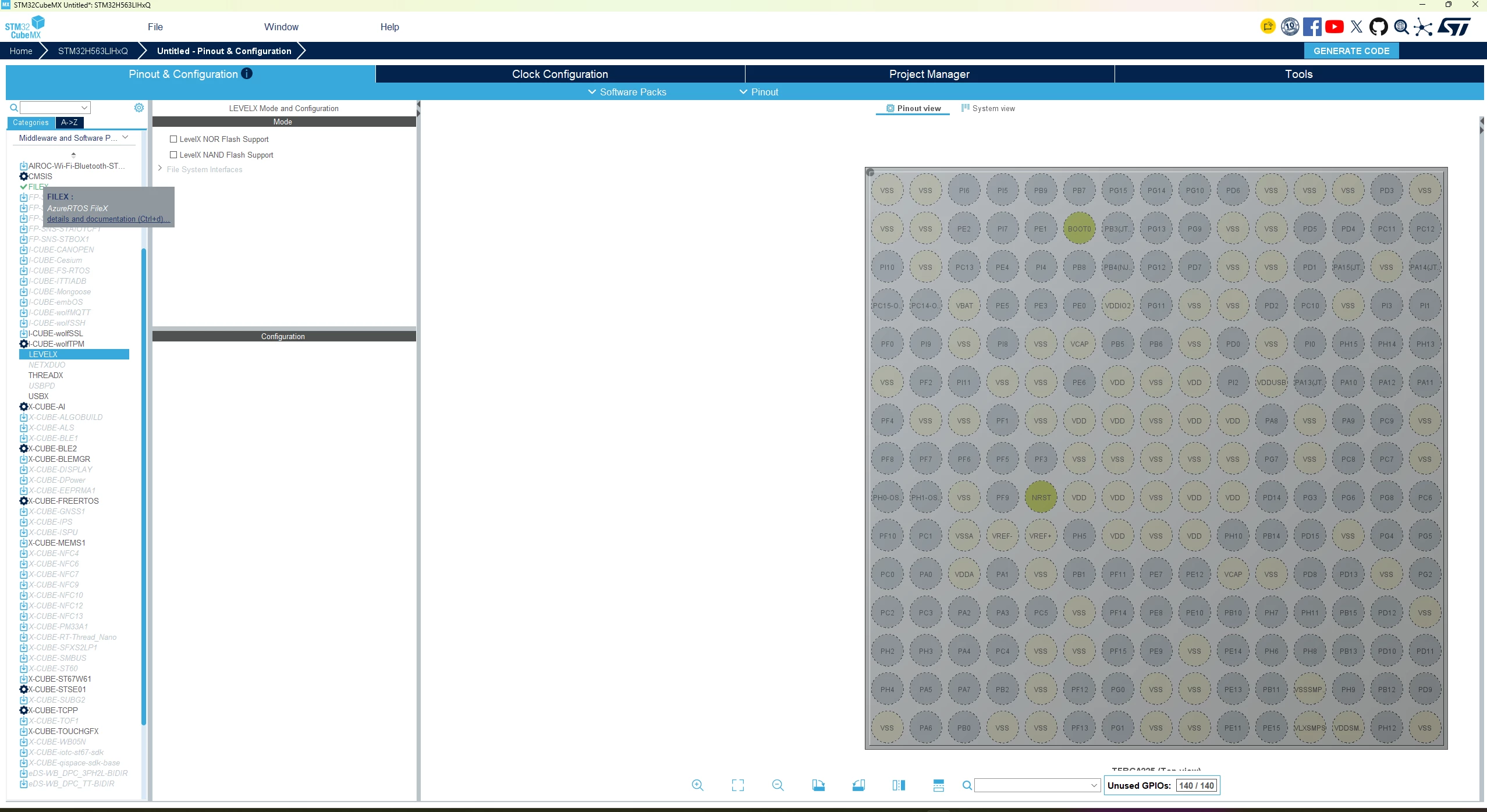

I updated to the newest STM32CubeMx 6.18.0
Now i miss X-CUBE-AZRTOS-H5 support.
I can see only an empty display after loading my .ioc file.

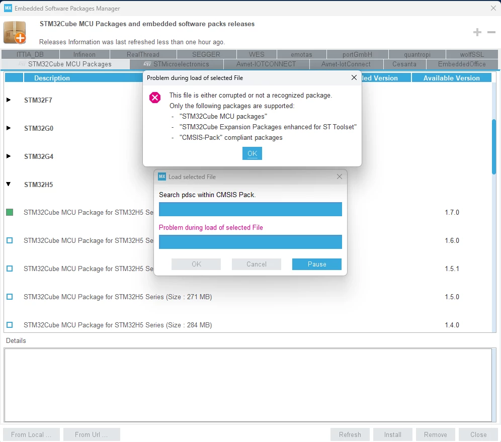

Hello ​@Gehs
ThreadX and FileX already appear in the Middleware section of STM32CubeMX for your STM32H5 MCU ,this means Azure RTOS support is already integrated and you do not need to install X-CUBE-AZRTOS-H5 separately.
In case of need , use this link to install it :X-CUBE-AZURE-H5 | Product - STMicroelectronics

Hello ​@Gehs
Could you please let me know why you are trying to download X-CUBE-AZRTOS-H5 and integrate it in STM32CubeMX  for your project ?
For STM32H5  Azure RTOS is already integrated natively in STM32CubeMX  so there is normally no need to use a separate X-CUBE expansion pack. In addition, X-CUBE-AZRTOS-H5 is not compatible with STM32CubeMX, so the recommended approach is to enable and configure ThreadX, FileX, USBX, or NetX  from Middleware section .

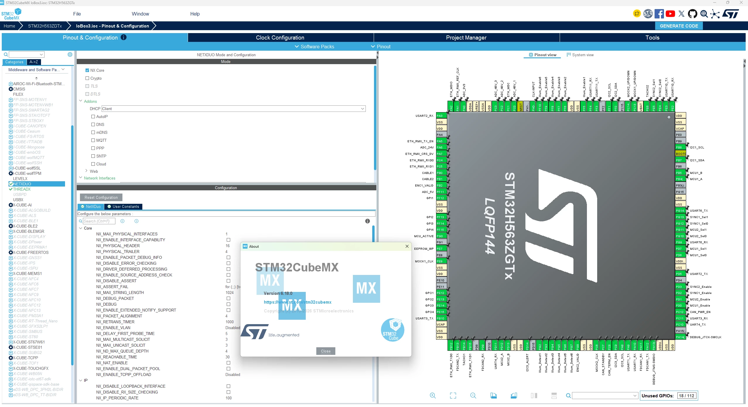

You are right!
Everything works if i create a new project.
The migration to CubeMX version 6.18 seems to fail.
So the problem seems to be in the .ioc file.
I attached that .ioc file.
I have also a simpler G070xx which migrated without any problems.

Ich bleibe nach Tests auf verschiedenen Rechnern bei meiner Aussage:
STM32CubeMX 6.18.0 hat ein Problem mit den H5-Prozessoren.
Die Migration funktioniert nicht richtig.
Die Oberfläche ruckelt und blockiert, auch wenn man mal migriert hat.
