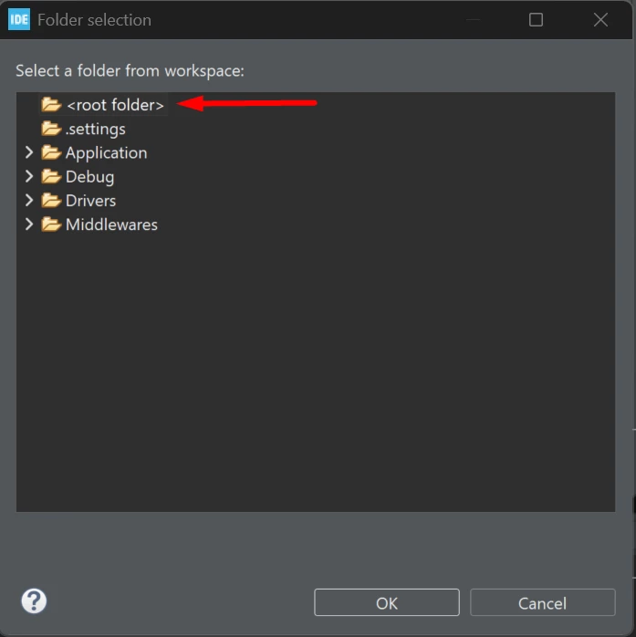

I have tried using STM32CubeMX 6.17.0 to generate an STM32F429 DISC1 project.
The generated project opened in STM32CubeIDE could not be compiled unless I add <root folder> in Project -> Properties -> C/C++ General -> Path and Symbols, the source location tab.
I don't know how this happen. It's disturbing to modify project settings each time after modifying the CubeMX and generating the project.
It's probably that should happened after I add some source folders to the projects.

Hello @NEdom.1
Let me thank you for posting.
The behavior described was not reproduced by my side.
The compilation completed without errors.
For more investigation, I recommend that you provide your Ioc.File.
Thanks.
Mahmoud

Thank you for your reply , @Mahmoud Ben Romdhane.
Here is the .ioc file from STM32F429 Discovery board template.
