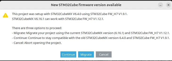

I have an ST32CubeMX project for a STM32H7 mcu generated with STCubeMX 6.4 and using STM32Cube FW_H7 V1.9.1 where the project files are generated via cmake. Now I want to use STM32Cube FW_H7 V1.12.1, but apparently, in order to be able to generate the new files, I have to migrate the project to STM32CubeMX 6.16.1:

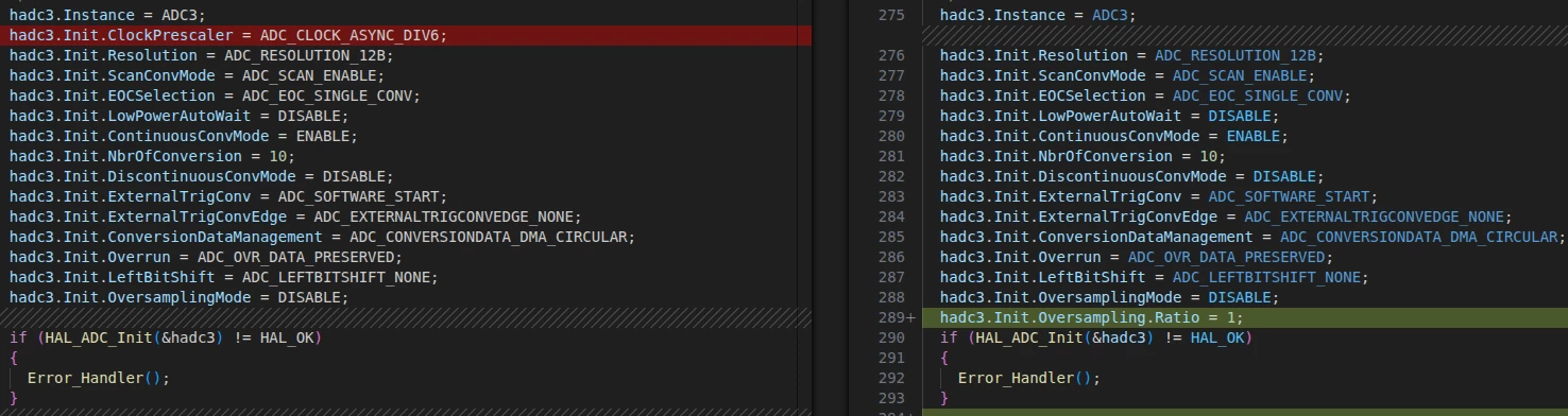

The problem is that, once I click in "Migrate", it removes two important lines from my code:

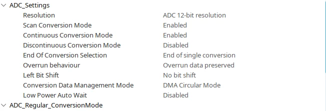

So, I went to CubeMX to check, and apparently, at a first glance, the field to configure ADC3 Prescaler is gone ( I do not have any other ADC on):

Further to your last comment, I confirm that the clock prescaler code line is not generated on static void MX_ADC3_Init(void).
The issue has been submitted to the dedicated team under this internal ticket (Ticket Number: 227955)

Hello Mahmoud, thank you for your reply. I think I am not allowed to share my ioc here, but I am using a STM32CubeMx 1.16.1, STM32Cube FW_H7 V1.21.1 and a STM32H743ZITx microcontroller. My main problem is that the ADC3 does not have the field to configure the prescaler anymore, neither I can configure a 150 MHz clock in the ADC Select Mux. This happened after I migrated my project from CubeMX 6.4.

As WA, I recommend that you add the code manually: hadc3.Init.ClockPrescaler = ADC_CLOCK_ASYNC_DIV6;
I will let you know when the issue is fixed.
