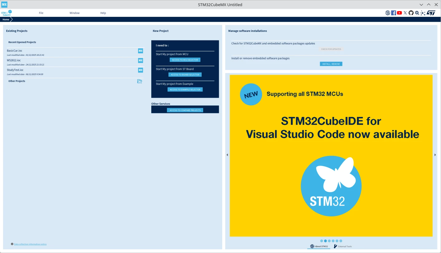

Hello ST Community,
I am writing to report a serious regression in STM32CubeMX 6.16.0 running on Arch Linux (KDE Plasma) with a 1920x1080 resolution.
Environment:
  • OS: Arch Linux (Rolling)
  • Java: OpenJDK 25
  • Desktop: KDE Plasma (Wayland/X11)
  • Screen Resolution: 1920x1080
The Regression (Comparison):
1. STM32CubeMX 6.15.0 (Previous Version):
  • Status: Works perfectly out-of-the-box.
  • Details: I did not need to modify any configuration files or set any environment variables. The application launched correctly, the UI was usable, and the window could be resized and maximized without issues.
2. STM32CubeMX 6.16.0 (Current Version):
  • Status: Unusable / Broken.
  • Details:
    • The default UI rendering has issues (fonts are tiny or behavior is inconsistent).
    • When trying to fix it using standard scaling methods (e.g., _JAVA_OPTIONS="-Dsun.java2d.uiScale=2" or GDK_SCALE=2), the window management breaks.
    • The window refuses to maximize, enter full screen, or resize properly. It seems internal window constraints have been changed, making it incompatible with 1080p screens when scaling is involved.
Conclusion: Version 6.16.0 has broken the stable "plug-and-play" experience that 6.15.0 provided on Linux. I have reverted to 6.15.0 for now. Please check the window size constraints and scaling logic in the new update.
Thanks.
ZackMakBest answer
Visitor II
Dec 5, 2025 3:39 AM UTC
STM32CubeMX doesn't work very well with Wayland. I have the same issue on Fedora 43 (KDE) as you do.
You may try this workaround.
Go to Display configuration -> Legacy application(X11) -> Scaled by the system
Unset the Java/GDK scaling environment variables.
The UI becomes a bit blurry as the system scales the UI by pixel. At least it is usable.

I understand that Arch Linux is not officially supported. However, I would like to point out two critical factors that suggest this is a software regression rather than a distribution-specific issue:
  1. Fedora uses KDE Plasma too: You mentioned Fedora is a supported distribution. Fedora offers an official KDE Plasma Spin, which uses the same Window Manager (KWin) and underlying display logic as my system. Since this issue (window size constraints and resizing locks) is related to the desktop environment interaction, Fedora KDE users are likely to face the exact same problem.
  2. Regression from 6.15.0: The previous version, 6.16.0, worked perfectly on this exact same machine and configuration without any issues. The fact that it broke immediately after the update strongly indicates a change in the internal window constraint logic of STM32CubeMX, irrespective of the underlying Linux kernel.
I am reporting this to help the development team identify a bug that likely affects supported distributions (like Fedora KDE) as well. I hope you can pass this feedback to the technical team.

VaZso
Dec 5, 2025 1:27 PM UTC
"Thanks" for STM32CubeIDE v2.0 has CubeMX integration removed, I have updated my STM32CubeMX and ran into this scaling problem.
I have a 4k monitor in a 15.6" laptop and wihout scaling, texts are very small... but with scaling, there is a small window what can not be resized.
So CubeMX is broken in a two different way - not working in CubeIDE and buggy in CubeMX form....(...)....
I am using KDE (X11) under Debian.
Visitor II
Jan 1, 2026 5:49 PM UTC
The CubeMX interface behaves incorrectly when resized on HiDPI displays.
In this specific case, the Linux distribution doesn't play a role in this bug (I tried several operating systems - Linux Mint, Ubuntu), because the app itself is written in Java and uses JavaFX/Swing libraries. So, the bug itself:
If the env GDK_SCALE=2, or if "-Dsun.java2d.uiScale=2" has been added to the startup command line, the maximum window size will be restricted to certain bounds. It cannot be changed.
The behavior is broken in several latest versions.
