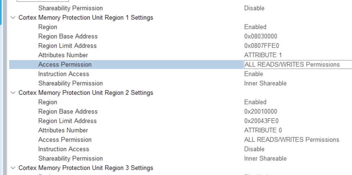

STM32CubeMX 6.15 STM32H523 Incorrect LL MPU code generation
Both Region 1 and Region 2 are configured with ALL READS/WRITES access permissions.
The resulting initialization code is as follows:
 /** Initializes and configures the Region 1 and the memory to be protected
 LL_MPU_ConfigRegion(LL_MPU_REGION_NUMBER1, LL_MPU_INSTRUCTION_ACCESS_ENABLE|LL_MPU_ACCESS_INNER_SHAREABLE, LL_MPU_ATTRIBUTES_NUMBER1, 0x08030000, 0x0807FFE0);
 LL_MPU_EnableRegion(LL_MPU_REGION_NUMBER1);
 /** Initializes and configures the Region 2 and the memory to be protected
 LL_MPU_ConfigRegion(LL_MPU_REGION_NUMBER2, LL_MPU_INSTRUCTION_ACCESS_DISABLE|LL_MPU_ACCESS_INNER_SHAREABLE, LL_MPU_ATTRIBUTES_NUMBER0, 0x20010000, 0x20043FE0);
 LL_MPU_EnableRegion(LL_MPU_REGION_NUMBER2);
The second parameter should also include the LL_MPU_REGION_ALL_RW attribute but it is missing.
The .ioc configuration file is attached.

Hello @peterdonchev
This issue has been resolved in the latest version of STM32CubeMX 6.17.0

Hello @peterdonchev
Thank you for your valuable contribution.
The issue has been escalated to the development team under internal ticket ID 221004 for resolution.
I will keep you updated as soon as new information becomes available.
