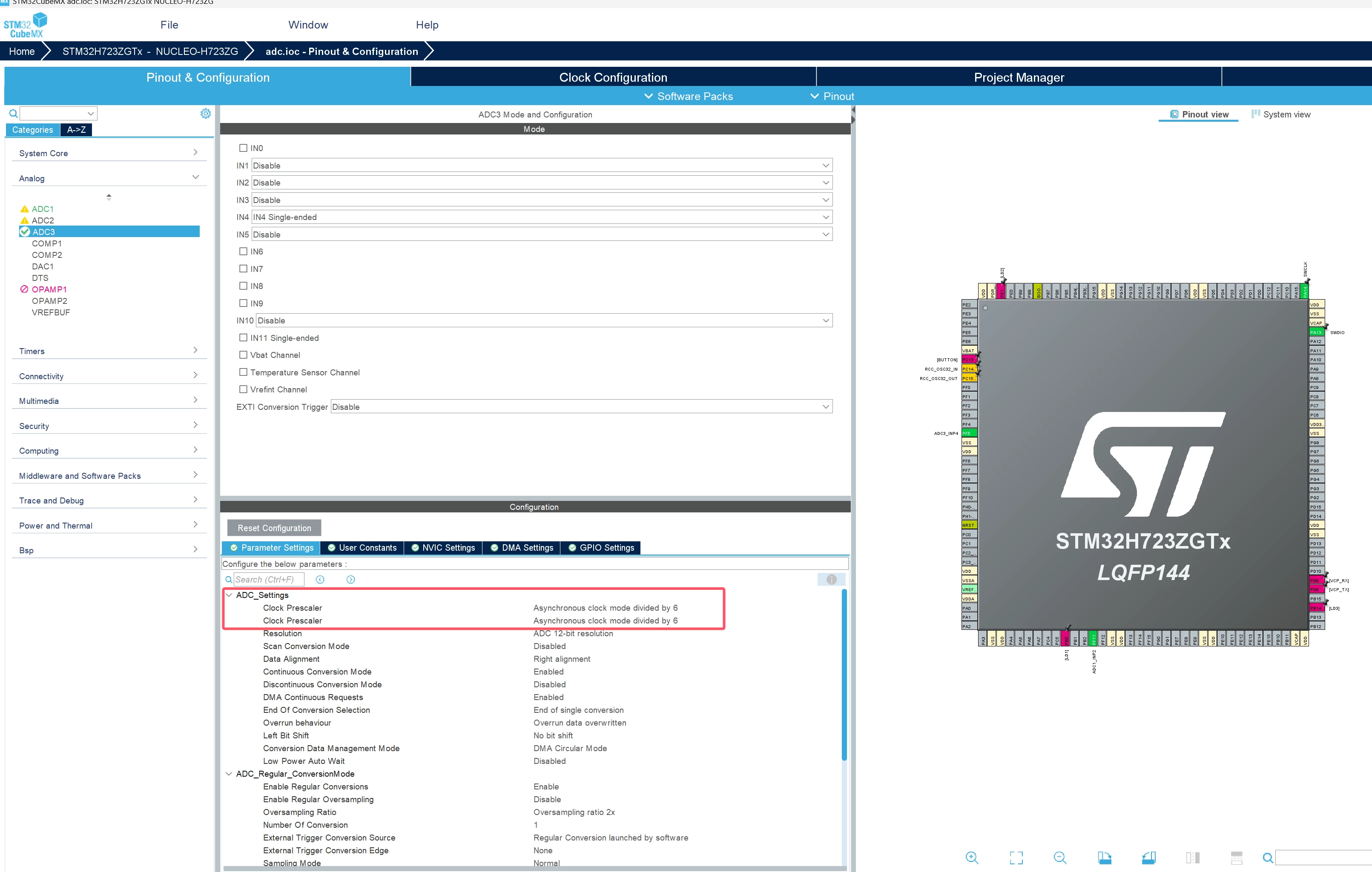

STM32CubeMX(6.15.0) bug for NUCLEO-H723
In the STM32CubeMX configuration interface, there are two identical options here.
They can be configured into different options.

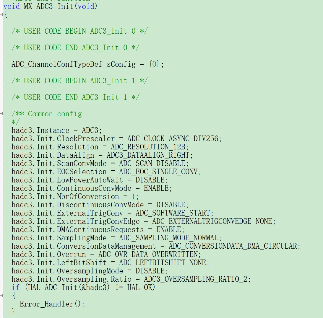

After generating the code, it will be based on the configuration of the second option.

Hello @istery
Thank you for bringing this to our attention.
I raised this internally (through ticket number: 217429) in order to fix this in the coming release of CubeMX.
Thank you for your contribution.
(PS: Ticket number 217429 is an internal tracking number and is not accessible or usable by customers).

Hello @istery
This issue is fixed in the STM32CubeMX version 6.16.0 which is published on ST website.
