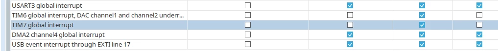

STM32CubeMX 6.12.0 Ignores "Generate Enable in Init" for Timers
I have an IOC for an STM32L433 that has TIM6 and TIM7 enabled, with interrupts enabled for both. In the NVIC settings for these two interrupts, I have deselected "Generate Enable in Init".

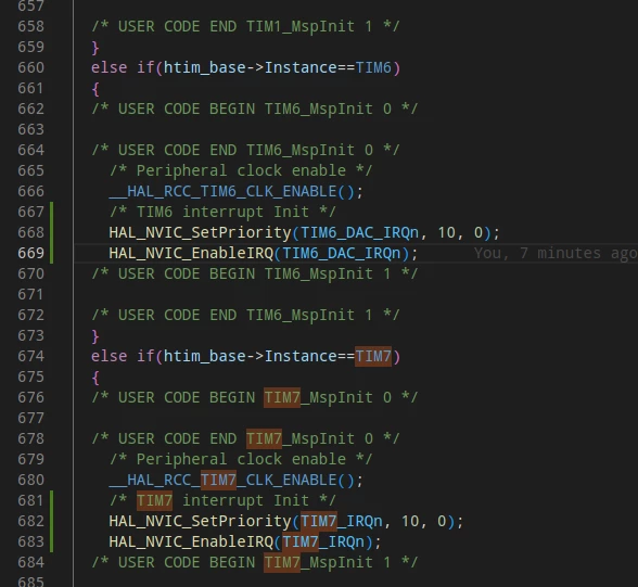

However, when the code is generated, the interrupts are still enabled in Src/stm32l4xx_hal_msp.c.
This seems like a bug.

Hello @Rob.Riggs
Sorry for my late replay, I'm not able to reproduce that issue after updating to the last STM32CubeMX V6.12.1 and SM32CubeIDE V1.16.1. Could you please confirm that.

@STTwo-32 confirmed. Works as expected. Should I have expected to see this called out in the release notes?
