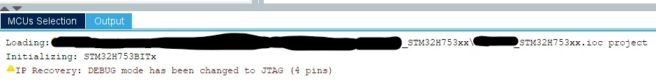

STM32CubeMX 6.11.0: automatically changing debug mode to JTAG (4 pins)
In the project that I saved-as (to rename) the DEBUG was set to JTAG (5 pins).
After updating to STM32CubeMX version 6.11.0 I observe the JTAG (5 pin) option is unavailable.
Below change (i.e. switched DEBUG to JTAG (4 pins))  was made by software automatically while saving the file.

Hello again @RajeevAroraCrcEvans
Thank you for your contributions and for your detailed explanations,
I confirm the issue on my side, it has been reported to STM32CubeMX development team .
Internal ticket number: 176646(This is an internal tracking number and is not accessible or usable by customers).
I will keep you posted with updates.
