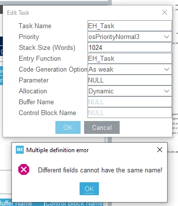

STM32CubeMX 6.0.1 not allowing same text for Task Name and Entry Function
Hello @Khouloud ZEMMELI​ ,
STM32CubeMX 6.0.1 not allowing same text for Task Name and Entry Function.
As per my understanding the text entered against property Task Name will be encapsulated in double quotes and will be assigned to variable name. The text assigned to Entry Function will become the name of the Task that will execute.
Why is the STM32CubeMX not accepting text EH_Task as a valid value and rather reporting "Multiple definition error"?
Please help with a fix.

Hello @Rajeev Arora​ ,
This will be internally checked, I'll give you an update as soon as possible.
