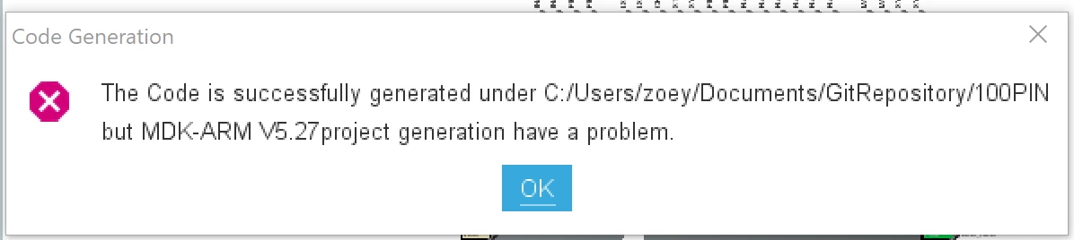

Install this version with Java 8 64-bit, still got this error.​
ArsRoberto
May 19, 2020
To solve the problem you have to completely uninstall java then install the latest cubeMX 5.6.1 then install the latest java, in the end you can open cubeMX you may see an error message about the java version (it doesn't detect the 64 bit java even if it's installed), just ignore the error, it'll work.
ArsRoberto
March 16, 2020
Hi, I'm having the same error that @Zoey​  have. I tried also to generate the project for keil V5 and V4 but nothing good.... If I open the generated keil project, Keil says that the target is not defined and the tree of files is empty.
Zoey
May 15, 2020
I tried 5.6.1 again today. When I still used the folder of my old project, the same error showed up. And I copied .ioc to an empty folder and generate the code from this .ioc, the error did not show up.

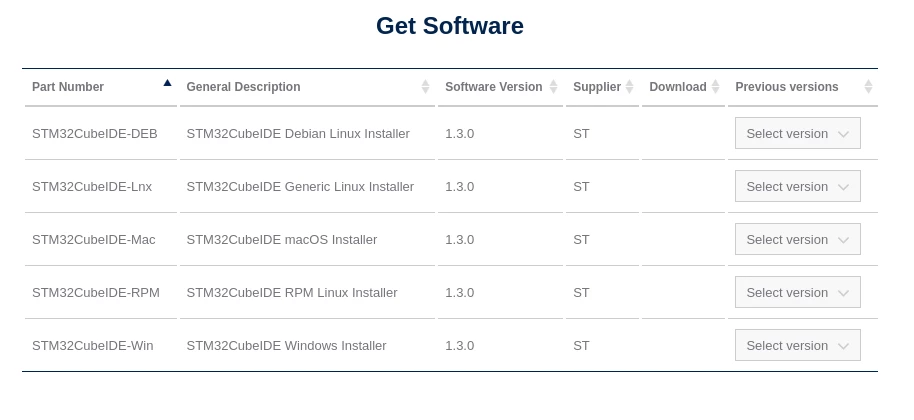

I cannot download STM32Cube MX nor STM32CubeIDE.
When I am logged in or click on the link in the email I see no download links:
Deleting cookies made no change.
Any ideas?
