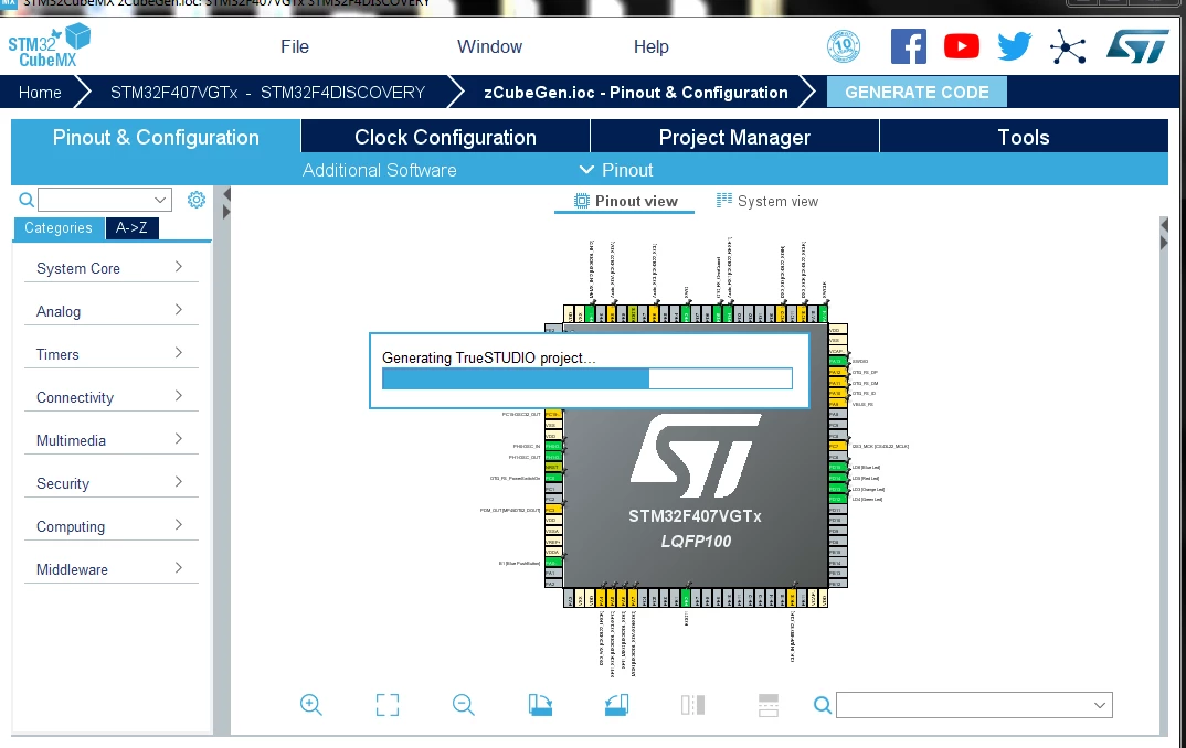

STM32CubeMX 5.6.0 (latest) Code Generation Freezes
I'm trying to generate the code on the STM32F407G-DISC1 evaluation board for the TrueStudio project environment.
The code generation just freezes.
Has anyone else seen this?
I'm running on Windows 7 Pro, 64 b0693W000000VReZQAW.pngit
I've tried different combinations of projects and processors but the result is the same.

Hello @SidBr​ ,
Please check if your project path location contains special character as "#" or "&".
Then, please keep us informed about your progress.

Thanks @Imen DAHMEN​
This was the problem.
Since I started working from home, the IT department gave me a laptop where the User account was “R&D�?, which appeared in the STM32CubeMX repository path.
I created a new admin user not containing an '&', and it now works.
This has solved most of my other issues.

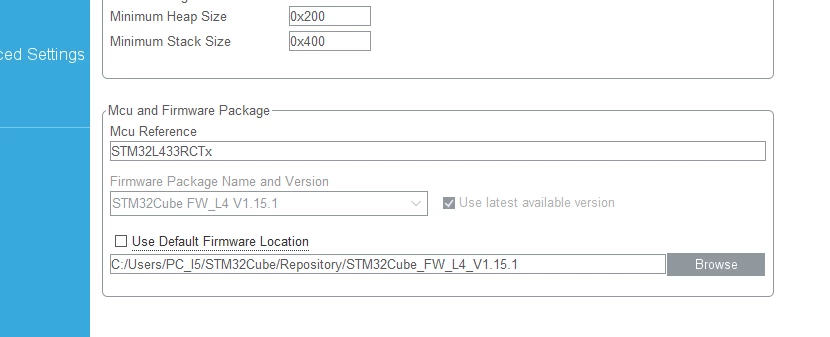

Take a look in the 'Project Manager' options and check to see what the path of the 'Repository' is.
'&' and '#' breaks the code generation.

Hello, I looked the path, i don't have any special caracters. My path is like that:
Jim Frederick_2
