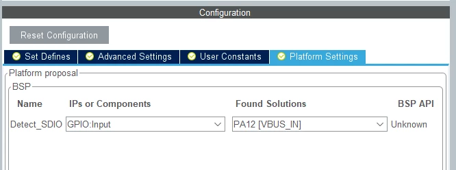

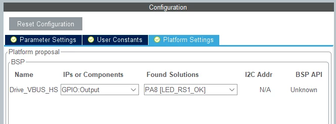

STM32CubeMX 5.2.0 - IP not configured or wrong parameter values
Using STM32CubeMX 5.2.0 in Windows 10.
When I hit the "Gererate Code" button, I see a pop-up window:
"WARNINGS: - These IPs still have some not configured or wrong parameter values:
[FATFS, Verify the Platform Settings Tab , USB_HOST, Verify the Platform Settings Tab ]
Do you still want to generate code ?"
FATFS and USB_HOST happen to show a green 'V'.
I can't seem to find any "Platform Settings Tab", where is it located?
Looking through the settings, I do not get where the problem comes from.
What can I check?

Hi @Jack​
Please try to finish the configuration of USB_HOST : Platform Settings => 0690X000008BSonQAG.png
Also the configuration of FATFS : Platform Settings => 0690X000008BSpHQAW.png
Then try to GENERATE CODE => now it must work correctly

Hi Nesrine, thank you, super! Because I don't use an SD Card detect switch, I didn't fill that one in. For the VBUS_HS, the proto-board was missing the track to the STM32H7. This solved the issue. And I found these Platform Settings TABs, after clicking FATFS and USB_HOST. Thank you very much! I assigned a few new pins for these (SD_DETECT input and USB_VBUS output).
