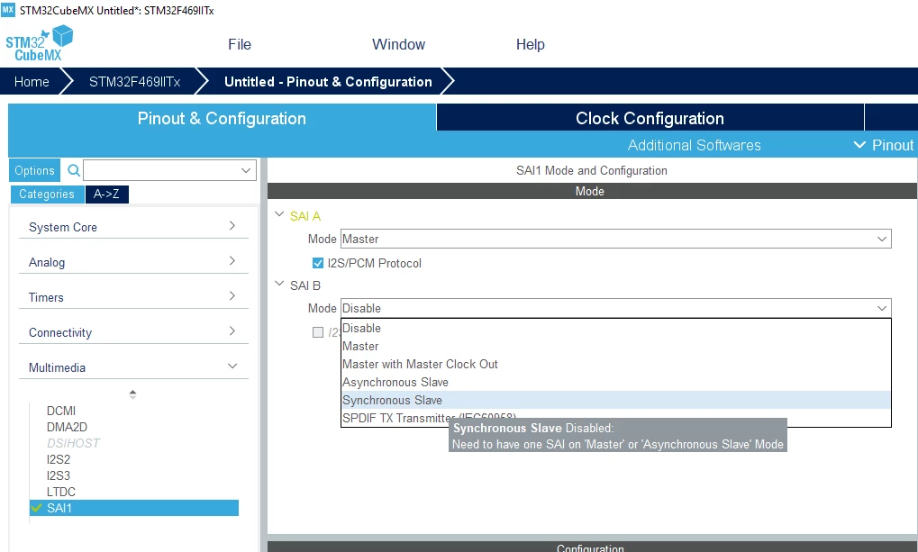

Lothar
Visitor II
Mar 14, 2019 8:03 AM UTC
0690X0000087x7RQAQ.pngSame Problem here with STM32F469IIT6 and SAI1 configuration issue.
We can't select the configuration showed in the screenshot.
BUT if we swap the mode setting (SAI B Mode Master), then synchronous slave would be selectable.
We looking forward to the next CubeMX relase.
Thanks in advance.
