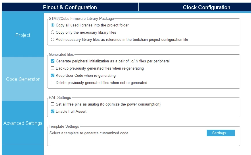

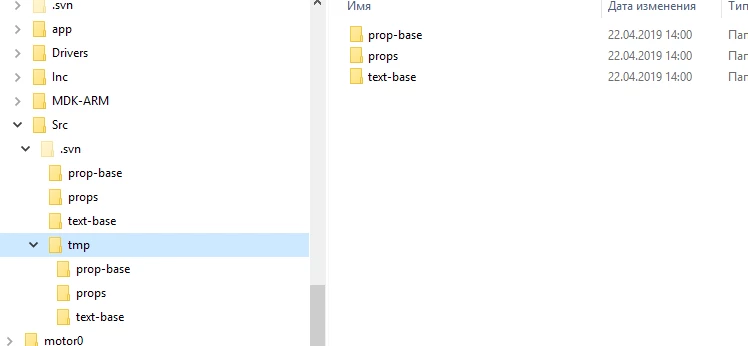

STM32CubeMX 5.1.0 delete .svn-files
  • April 23, 2019
  • 1608 views
...and damage SVN-repo.
files tree:
after generate files:
settings:

Pavel A.
April 23, 2019
This is a somewhat tactless hint that your svn version is too old.
Modern svn keeps its stuff only in the root directory of the repository.
-- pa
Andrey1
Andrey1Author
April 24, 2019
Unfortunately there is no choice
