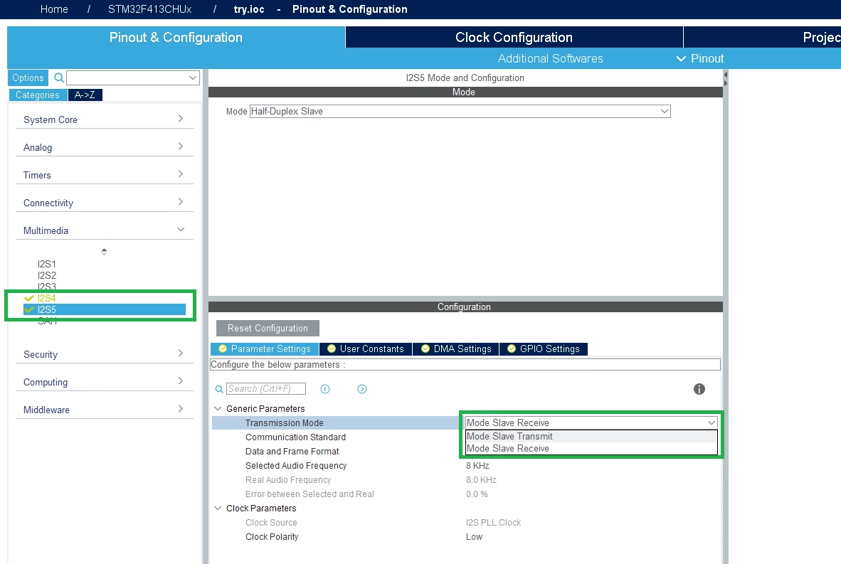

STM32CubeMX 5.1.0 Bug Report - STM32F4 I2S4, I2S5 Halfduplex RX mode config and code gen missing.
STM32F413, Cube 5.1.0 plugin to SW4STM32, with Library STMR32Cube_FW_F4_V1.24.0.
In previous versions we were able to set the transfer direction for I2S4,I2S5 half duplex channels. In the above version only transmit can be selected and the ability to select receive mode has been incorrectly removed. This is a CRITICAL regression test failure as what code generation that WAS working IS NO LONGER is working. FIX NOW!!!

---In the above version only transmit can be selected and the ability to select receive mode has been incorrectly removed.---
Rep : You can select both mode (Transmit and Receive are available ) with the 5.1 CubeMX version  .

Thank you and my apologies at having overlooked something in setup that should have been obvious. I think that it would be helpful from a GUI standpoint if, in the Parameter Settings Panels that select fields had the conventional down arrow indicator to remind us that that alternative settings are available for that value. This is so that the selection field is differentiated from constant label text.
