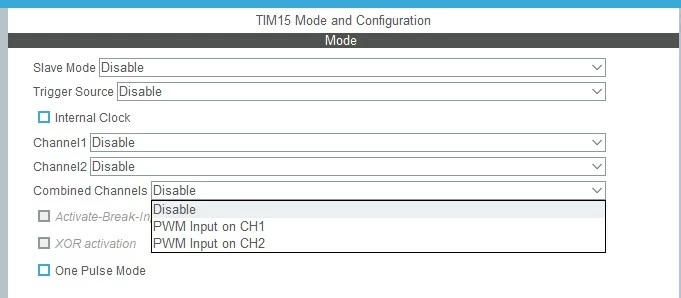

STM32CubeMX 5.0.1: TIM15 missing "Combined channels = XOR ON" setting
MCU: STM32F303RETx
Firmware: STM32Cube FW_F3 V1.10.0

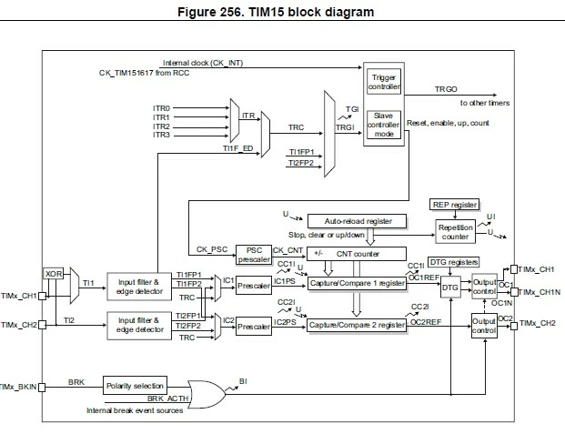

In TIM15 -> Mode -> Combined Channels it is not possible to select XOR input on TI1:
In the reference manual (RM0316) at page 685 you can see the XOR input:
And at page 720, the register TIM15_CR2[TI1S] description:0690X000006DRd7QAG.jpg
So I suppose that there really is the possibility of activating the XOR input for TI1 of TIM15, but the possibility of doing it in STM32CubeMX is missing. Maybe a BUG?

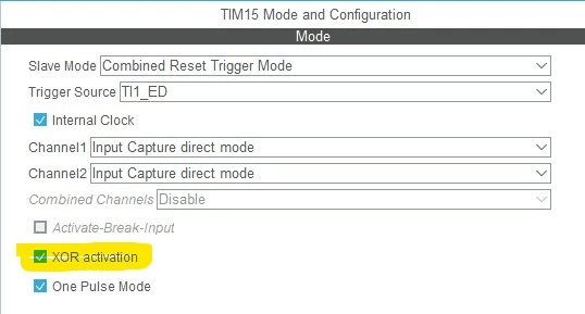

Sorry, I'm really stupid! I did not realize that there is a flag to be activated to enable the XOR function:
I thought that the XOR setting for TIM15 was identical to those of the other timer, but I was wrong.
