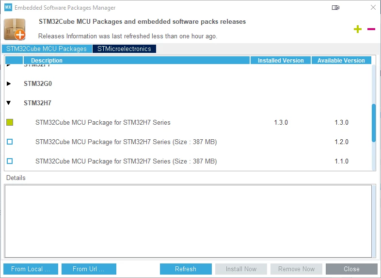

Hi, when I want to generate code for an STM32H743ZI, a popup appears:
"The Firmware Package (STM32Cube FW_H7 V1.3.0) or one of its dependencies required by the Project is not available in your STM32CubeMX Repository. Do you want to download this now ?"
Sure enough I do, and then it ends with this error:
"Error downloading the following files:
stm32cube_fw_h7_v130.zip (Target directory already exists)"
and
"Unzip File : stm32cube_fw_h7_v130.zip
Problem during Download and/or Unzip of selected Files"
I run STM32CubeMX in admin mode on windows 10.
What can be the problem? How do I solve it?

> "Target directory already exists"
I would try to delete the target directory and retry =)
Open Help->Updater Settings
Browser into your repository directory [click Show More]
Delete the existing STM32Cube_FW_H7_V1.3.0 directory
Open Cube and try to download/install the package again
If it fails again, close Cube and try to extract the downloaded ZIP file manually.

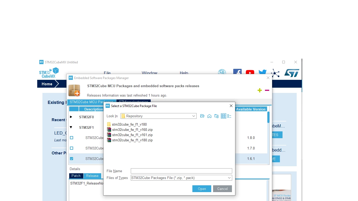

Just now I found my repository path, it was c:\Users\jbk\STM32Cube\Repository
This is what also worked:
Home -> Install / Remove -> From Local ... and browse to the zip file.
So that might be another work-around.

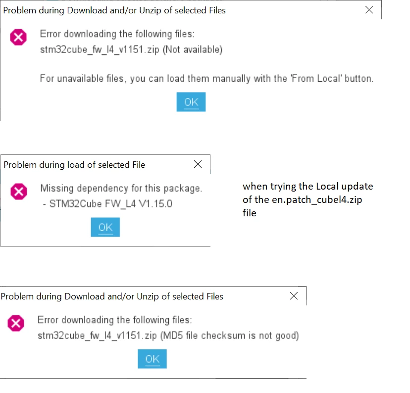

Hello ST,
please help out with the latest version of the STM32Cube MX for L4, that fails to update the STM32CubeL4 Firmware Package V1.15.1.
I have tried many options, and the update simply does not work. The ioc file has already been converted to 1.15.0 and I cannot generate code, as it gets stuck on missing the V1.15.1 package. These are the various error messages encountered while trying different options:0690X00000DXIr1QAH.png
