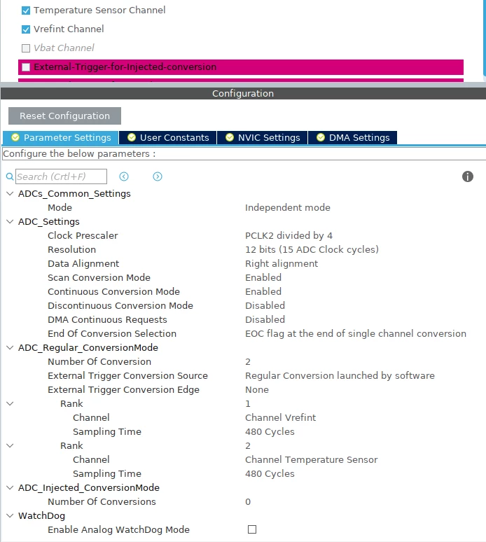

Hi
I'm trying to configure my project with STM32CubeIde 1.2.1
I want to use ADC1 to perform temperature and vrefint measurement.

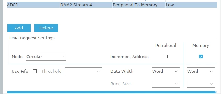

So I configure my adc & dma :
But I'm not enable in cube to enable the DMA option, only disable is possible.
If I enable the flag manually in the code generated, I don't have any problem and the code is running as expected (continuous acquisition of both channel with an interrupt each time the acquisition is complete)
Is there a reason this option isn't possible in cube ?

​Issue will be fixed in the next release.

​Hi @Community member​ , to abtain the fix you need to to migrate your project in a CubeMX version greater or equal than 5.4 , so  please follow those steps:
1 – Update the CubeMX version in the CubeIDE with a version greater or equal than 5.4
2 - Modify in the IOC following parameter value from false by true  , ProjectManager.AskForMigrate=false
3 - Load the IOC and answer « Migrate » to update the project with the ability to enable the DMAContinuousRequest

It's working (update to 5.5)
