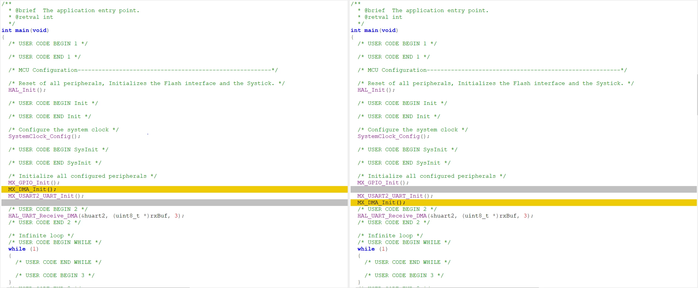

STM32CubeIDE v1.7 generating incorrect code for Uart DMA - STM32f4
I have observed an issue with STM32CubeIDE v1.7.0 whereby the auto generated code is in the incorrect order for Uart DMA reception.
Below, I compare the generated main.c file from CubeMX v6.3.0 [Left] STM32CubeIDE v1.7.0 [Right] both using the firmware pack STM32FW_F4 V1.26.1
This issue was also reported and supposedly fixed in CubeMX.
My software and hardware:
STM32CubeIDE v1.7.0 & STM32FW_F4 V1.26.1
CubeMXv6.3.0 & STM32FW_F4 V1.26.1
STM32F446RE - Nucleo64
