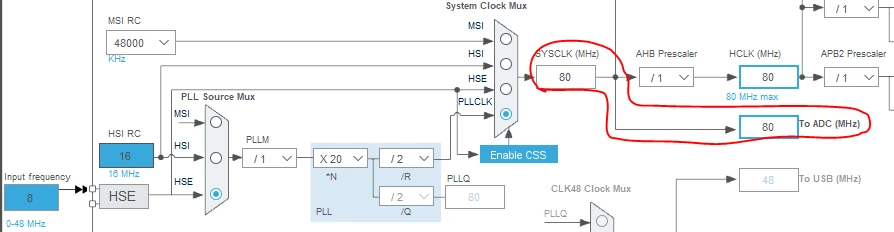

MMart.20
Visitor II
Aug 19, 2021 12:37 PM UTC
I am getting the same error after the latest update. I hope they push a fix soon.
MMart.20
Visitor II
Aug 30, 2021 12:06 PM UTC
Hi again,
I've had some time to look into this and the STM32L412's ADCs take their clocks from the SYSCLK, so the clock selection would not have any effect (other STM32L4xx can have different ADC clock sources, so they would have a clock mux in there). You can comment out the "PeriphClkInit.AdcClockSelection = ADCCLockSelection;" line and the ADC will still have its clock.

MMart.20
Visitor II
Oct 22, 2021 7:17 AM UTC
You can just comment out those two lines. There is no clock mux to configure, so the ADC will work.
