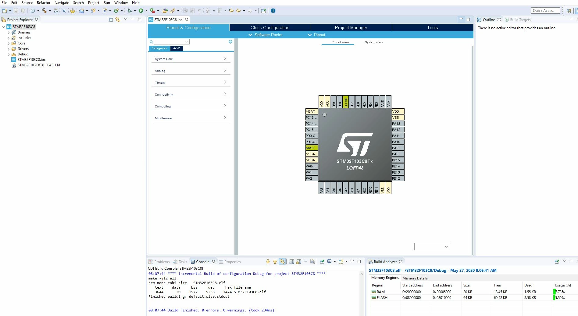

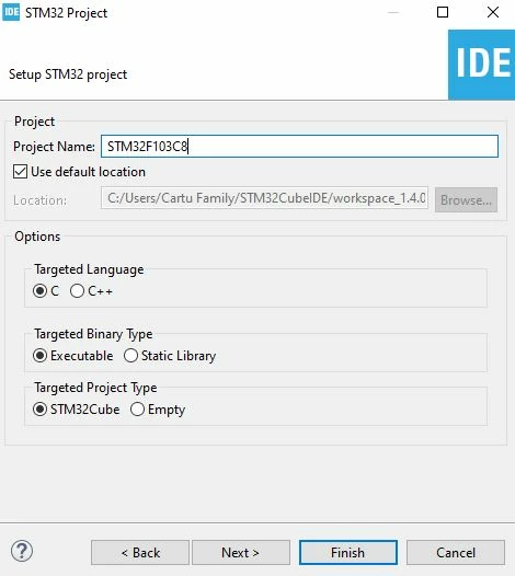

Cartu38 OpenDev
Graduate II
May 27, 2020 6:13 AM UTC
Works like a charm on my side. 5 mouse clicks required on my side to get a compile success on such target device.
1) Open File > New > STM32Project wizard
2) Select your device
3) Add a project name keeping default settings
4) Press Finish button
5) Compile
