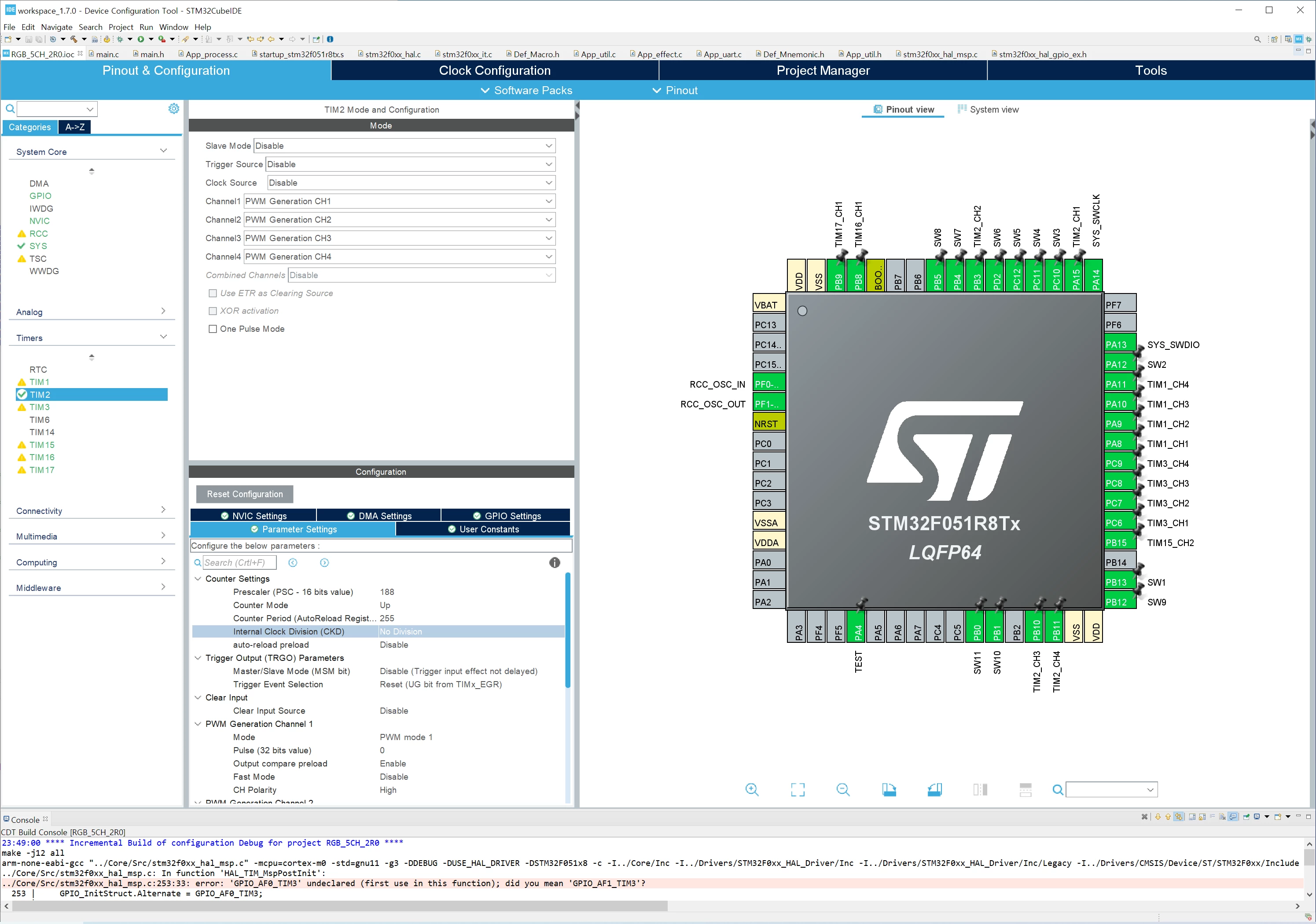

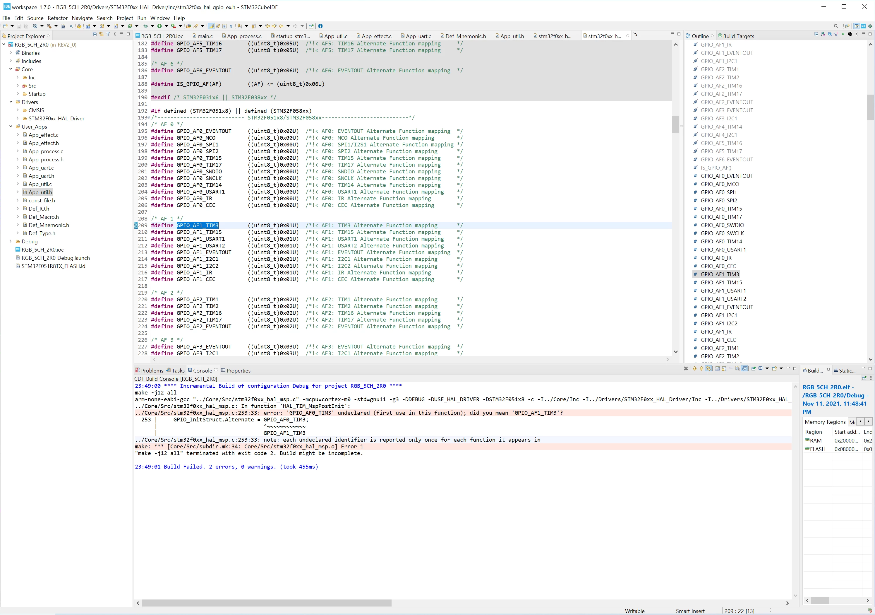

0693W00000GXHqsQAH.png0693W00000GXHrHQAX.png0693W00000GXHpRQAX.pngUse TIM3 PWM --> GPIO_AF0_TIM3
but #define GPIO_AF1_TIM3
Error??

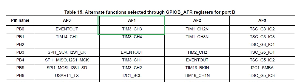

Actually you're right, the build problem occurs when remapping TIM3_CH3 function to a pin other than PB0 pin (PC8) .
In fact, backing to the STM32F051 Data Sheet, TIM3_CH3 is AF1:TIM3 Alternate Function selected through GPIOB_AFR registers for port B:
0693W00000GY4tMQAT.pngWith this being said, this problem is reported internally to be fixed. I'll keep you posted with updates.
Internal ticket number: 117811 (This is an internal tracking number and is not accessible or usable by customers).
Sorry for any inconvenience that this may cause.

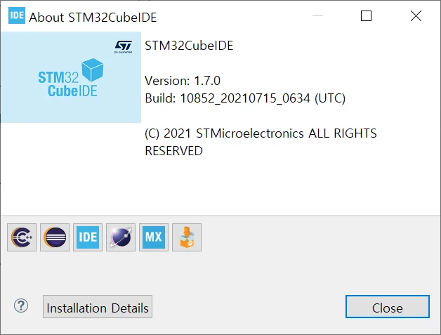

So, why does the error occur when I generate the code in STM32CubeIDE 1.7.0? 2021년 11월 12�?� (금) 오후 10:04, ST Community 님�?� 작성:
SMj.1
SMj.1Author
November 15, 2021
November 16, 2021
The CubeIDE is integrated CubeMX. So you generate your project through cubeMx.

STM32F051R8T6 PC6 ------> TIM3_CH1 PC7 ------> TIM3_CH2 PC8 ------> TIM3_CH3 PC9 ------> TIM3_CH4 ../Core/Src/stm32f0xx_hal_msp.c: In function 'HAL_TIM_MspPostInit': ../Core/Src/stm32f0xx_hal_msp.c:131:33: error: 'GPIO_AF0_TIM3' undeclared (first use in this function); did you mean 'GPIO_AF1_TIM3'? 131 | GPIO_InitStruct.Alternate = GPIO_AF0_TIM3; | ^~~~~~~~~~~~~ | GPIO_AF1_TIM3 ../Core/Src/stm32f0xx_hal_msp.c:131:33: note: each undeclared identifier is reported only once for each function it appears in 2021년 11월 16�?� (화) 오후 11:57, ST Community 님�?� 작성:

Hi @SMj.1​ ,
You are right, I reproduced the same issue with CubeMx 6.3.
I will escalate this issue internally to CubeMx team for fix.
Even though this reply doesn’t directly solve the issue, I’m marking it as Best, since it will help clarify the current situation for other customers with the same question. I will post an update here once the issue has been fixed.
