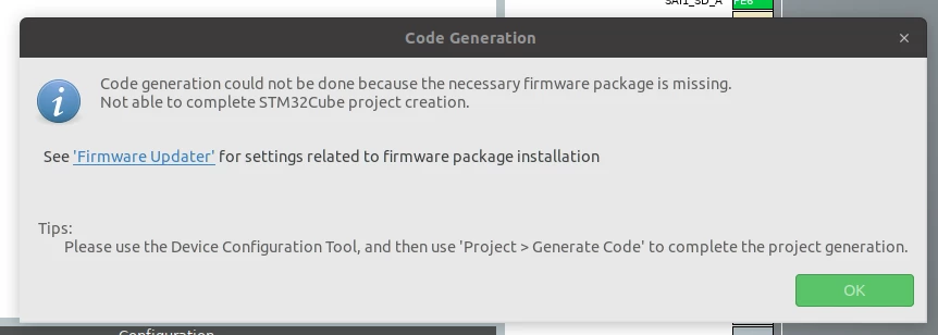

I imported a TrueStudio 9.3 project into stm32cubeide 1.0.0.
Everything was fine until i made a modification in CubeMx and regenerated code !!!
I had a code generation error then All my files and folder were deleted.
Yes i have a recent backup but that's really frightening !

Doesn't the error message help you ? I have no idea why i had it but it seems linked to my project folder deletion.

JJug
Visitor II
Aug 13, 2019 6:59 AM UTC
Hi Markus, check my problem here.
https://community.st.com/s/question/0D50X0000Ap1NYTSQ2/bug-stm32cubeide-deleted-all-my-source-code-generate-code-on-imported-project
I did uninstal 1.7.0 manualy and then tried to build solution. IDE (1.0.2) then asked me to install back 1.7.0 and after that I got message that Ixox posted screenshot up there. After that the code was lost.

Sounds lacking firmware packs at a time may have lead to such behavior pain. Definitively a bug.
Sounds some improvements have been done fixing such issue Thanks STM32CubeIDE V1.1.0 just released on st.com
