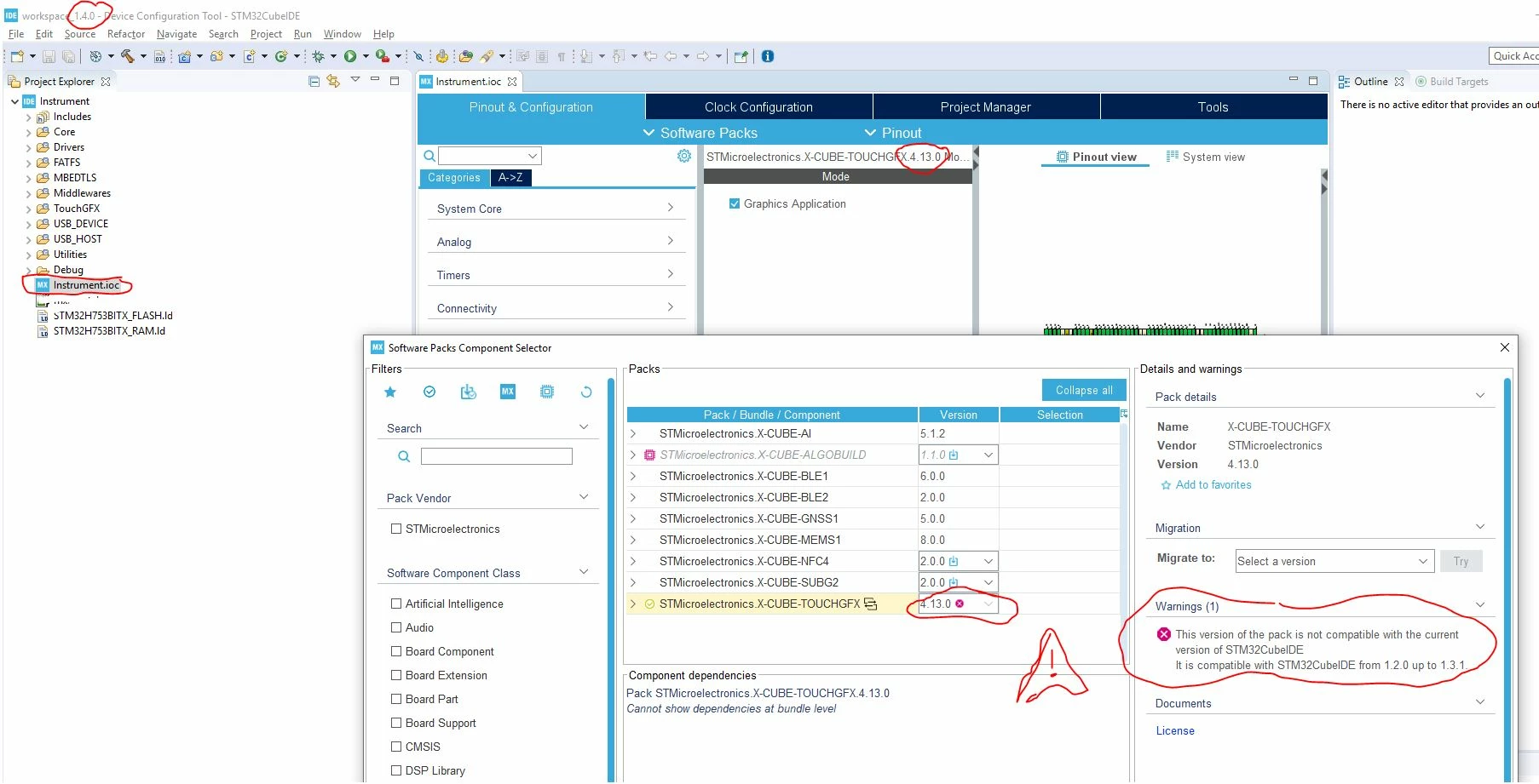

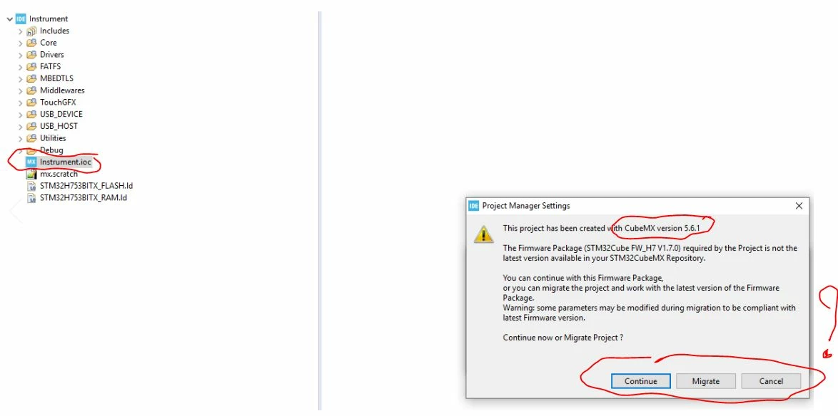

@AWies.1​ good and bad news ... I'm able to reproduce and confirm your issue.
Based on your .ioc file if 1.3.1 project is generated fine.
Moving then to 1.4.0 and asking for project update from device configuration tool is performing almost full project removal :o :sad_but_relieved_face:

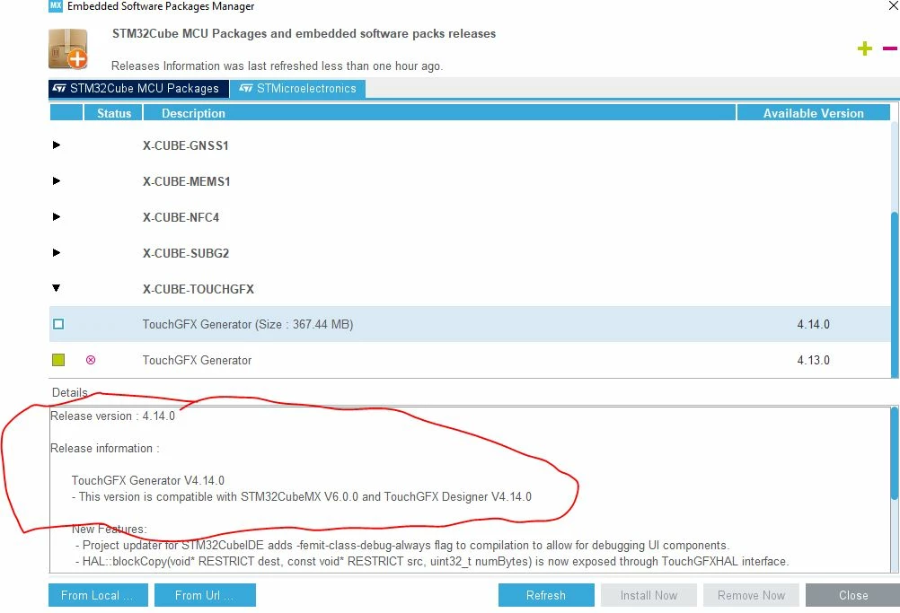

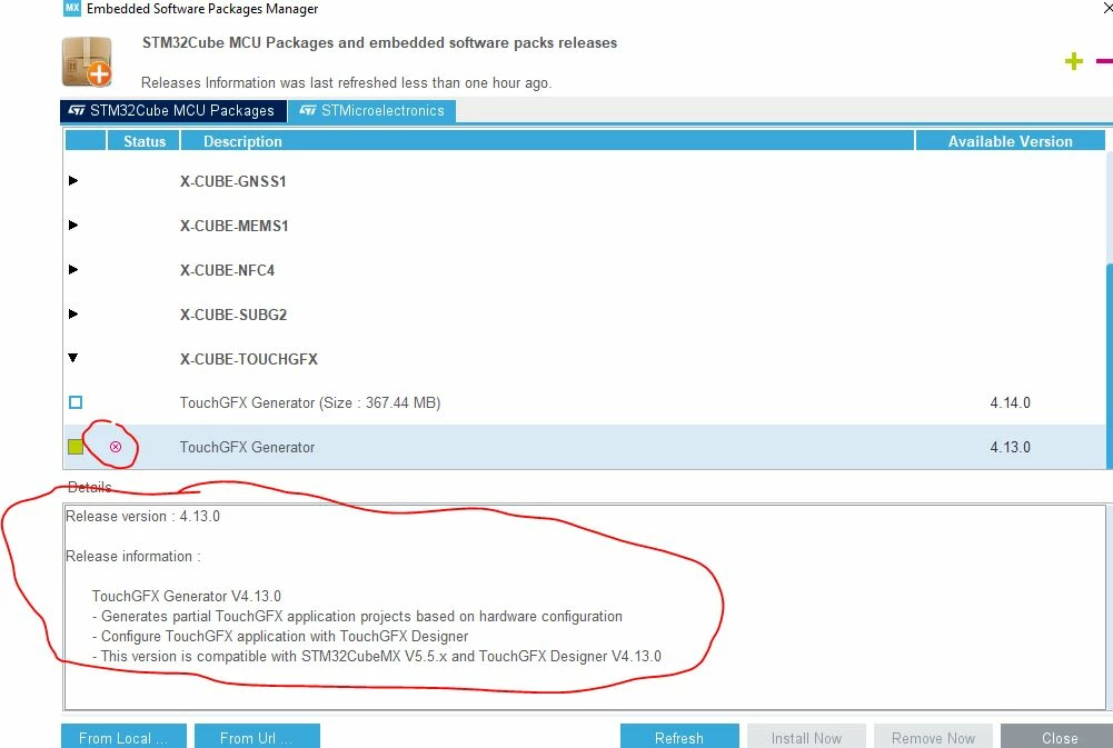

Not mastering such enough but sounds related to the fact your're using TouchGFX pack. Device configuration tool is claiming 4.13 is not supported. have to migrate to 4.14 ....
I've not tried but maybe taking care of some migration option is doing proper job ? @Martin KJELDSEN​ @Alexandre RENOUX​ @Romain DIELEMAN​ TouchGFX experts please help here !

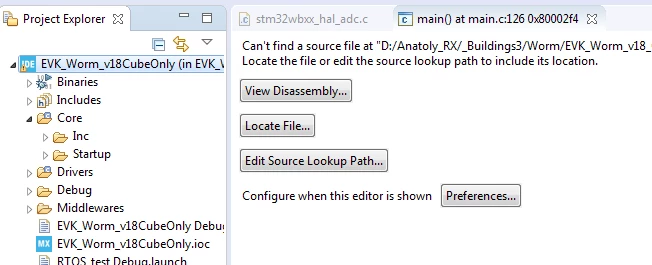

I have got problem with CubeIDE 1.41 on Windows. CubeIDE sometimes delete \Core\Src folder of projects. I often delete projects from IDE but never check Delete project content on disk. After deleting I am copy project with new folder name, open it on IDE and rename. This is my simplest control version system. The joke is that I can build and debug project without \Core\Src. Before project Clear of cause...
Also there is problem with slash direction. I usually use CubeIDE on Ubuntu, but sometime on Windows.
