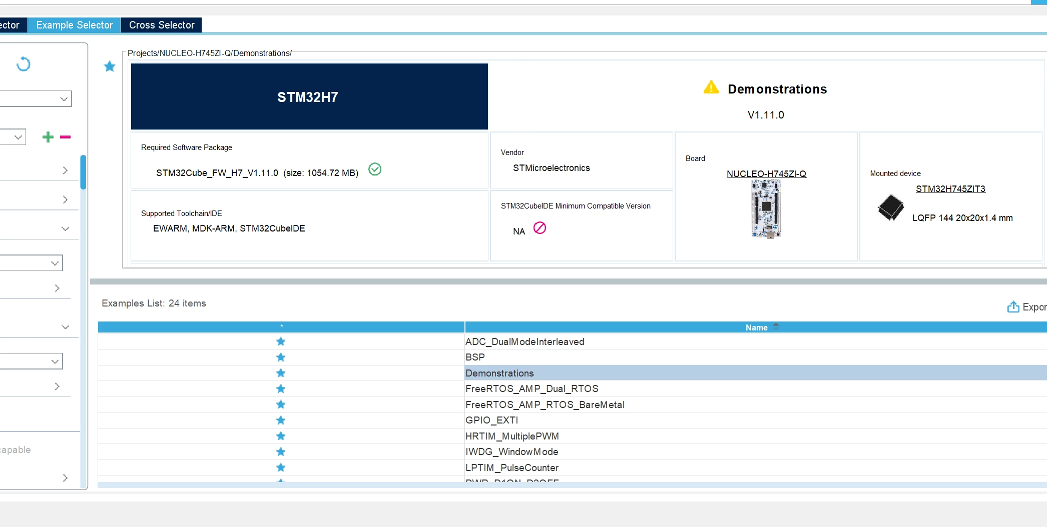

Hi all,

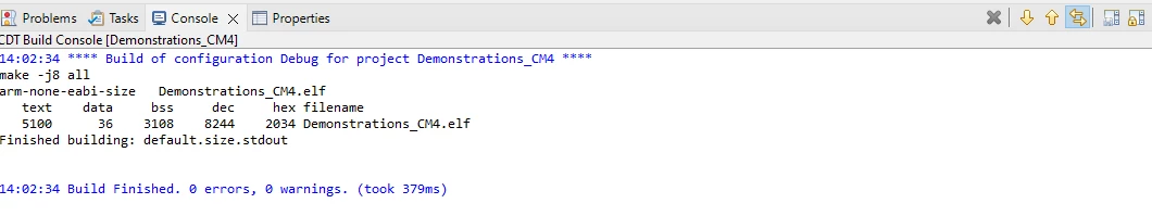

I'm trying to use STM32CubeIDE to create a project for this board from the list of "Examples Selector". I picked "Demonstrations" as seen in the picture. I don't see a ".ioc" file and when I try to build I get these errors:
Description Resource Path Location Type
make: *** No rule to make target 'C:/Users/myUserName/STM32W/Demonstrations/STM32CubeIDE/Utilities/lcd/stm32_lcd.c', needed by 'Utilities/stm32_lcd.o'. Stop. Demonstrations_CM4 C/C++ Problem
make: *** No rule to make target 'C:/Users/myUserName/STM32W/Demonstrations/STM32CubeIDE/Utilities/lcd/stm32_lcd.c', needed by 'Utilities/stm32_lcd.o'. Stop. Demonstrations_CM7 C/C++ Problem
I tried 3 different projects and all 3 don't have the ".ioc" file. That's the file that shows the visual configurator pinout among other things. In a effort to find out more I picked a different board (NUCLEO-L476RG, example "GPO"). This time I get an ".ioc" file and the project builds without errors.
I'm new to STM32 and the whole ecosystem. The NUCLEO-H745ZI-Q is dual core, the NUCLEO-L476RG is single core. How do I get the dual core project to show the ".ioc" file ... and build without errors?

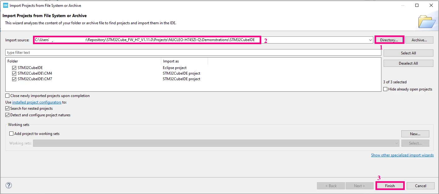

Best answer by KDJEM.1
Hello @Rodo​ ,

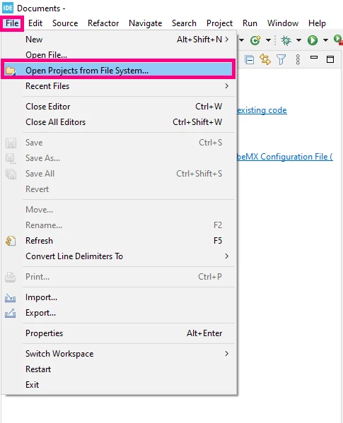

To import the project in STM32CubeIDE1.12.0 version, I recommend you to follow these steps:
1- Open STM32CubeIDE1.12.0 version
2- Click File-->Open Projects from File System as shown in the below figure
_legacyfs_online_stmicro_images_0693W00000bkHm7QAE.png3- Browse the Demonstrations\STM32CubeIDE project file located in this path "STM32Cube_FW_H7_V1.11.0\Projects\NUCLEO-H745ZI-Q\Demonstrations\STM32CubeIDE" as shown in the below figure

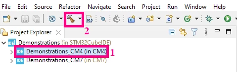

_legacyfs_online_stmicro_images_0693W00000bkHoXQAU.png4-Build the Demonstrations_CM4 project as shown in the below figure

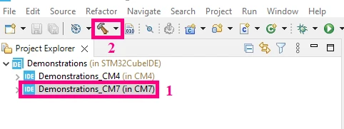

_legacyfs_online_stmicro_images_0693W00000bkHp1QAE.png5-Build the Demonstrations_CM7 project
_legacyfs_online_stmicro_images_0693W00000bkHpVQAU.pngI hope this help you!

Hello @Rodo​ ,
Which STM32CubeIDE version are you using?
I made some tests using STM32CubeIDE.1.12.0 version and the STM32Cube_FW_H7_V1.11.0 firmware version and I didn't find any issue.
Please, try to use the last STM32CubeIDE version and let me know if the problem is solved.

I have STM32CubeIDE 1.12.0. I'm new to STM so I just installed it about a month ago. I don't know how to check "STM32Cube_FW_H7_V1.11.0 firmware". The picture I posted shows this version. I had a friend check this demo using his Linux machine and got the same error as me. There was no ioc file and he got the two make errors I showed in my post. I don't have the default workspace folder name though I changed it to "STM32W" maybe that makes a difference?
Is there a way for you to zip the project and post it here?

Hello @Rodo​ ,
You will find attached the zip file.
