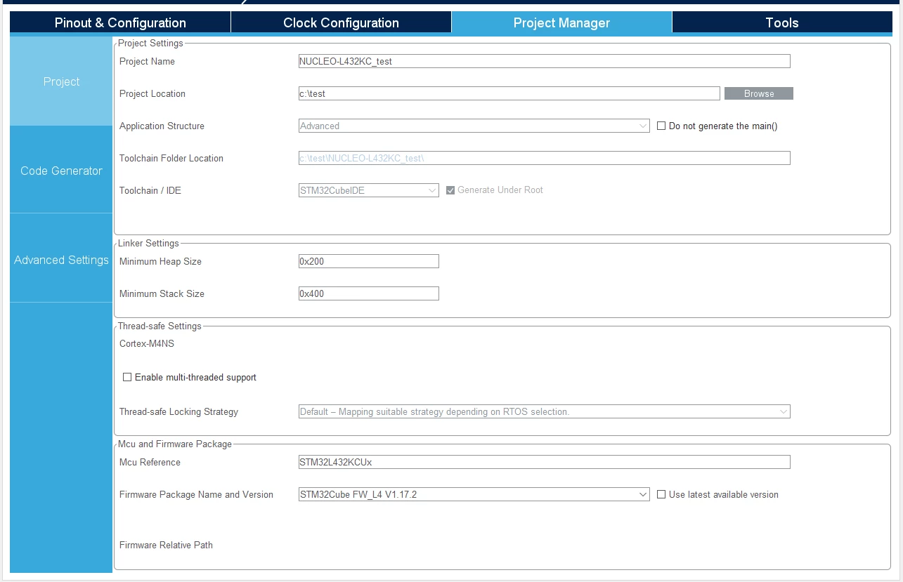

one cannot set a custom firmware path, checkbox and path entry are missing, see attached screenshot.
Same works on CubeMX 6.5.0
hth

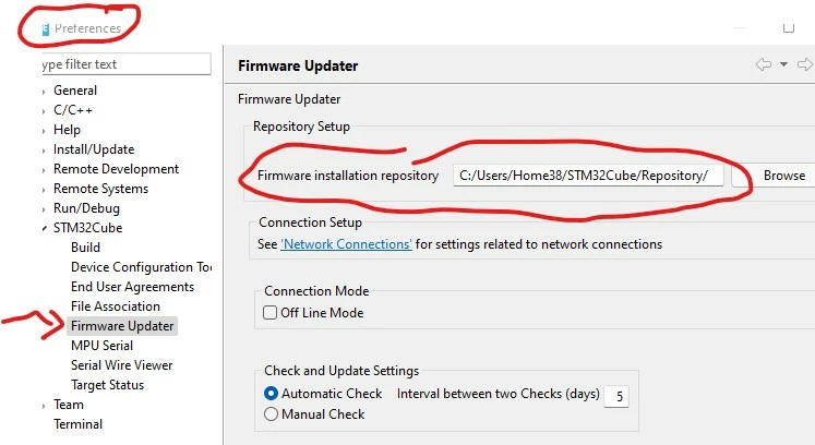

Maybe such is helping you:
0693W00000LzJXPQA3.jpgThis way you can set your own global local repo if FW packs. But I would recommend to point on expected FW pack release.
You have many ways thru file system to force version you want but part of your own risk then. It may perfectly work or not ... depends on IPs you're relying on etc etc ...
True STM32CubeIDE is claiming STM32CubeMX integration and myself I consider such is validated. But integration does not mean 100% match some features or options from time to time are lacking relying on good reasons I guess ... I may agree an IDE context is not same that a point tool one.

My use case is: no internet access to the ST servers (corporate network, firewalls, ...) and the firmware repository is on some centralized local server with a non-default path.
Moreover, the feature is present in CubeMX and STM32CubeIDE claims (about box) to integrate
STM32CubeMX - STM32 Device Configuration Tool
Version: 6.5.0-RC4
Build: 20220225-1913 (UTC)
Btw, you can pick older firmware release in CubeIDE, this works. Only the path entry missing.
hth
