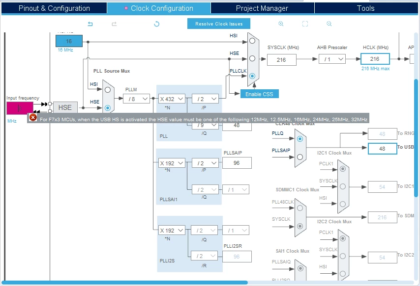

STM32CubeIDE 1.4.2 Device Configuration Tool, STM32F723, HSE value warning about USB HS when USB HS is inactive
STM32CubeIDE 1.4.2 Device Configuration Tool warns me about HSE value and USB HS when there is only USB FS activated. My ioc file in attachment.

Hello @SPlya.1​ ,
Thank you for your feedback , I will raise this internally to CubeMx team for review.

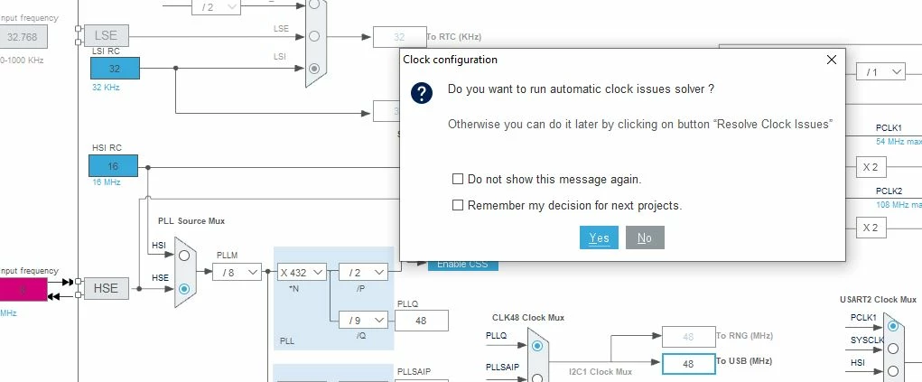

You can run automatic clock issues solver or click on Resolve Clock Issues to pass over this warning.

Hi @SPlya.1​ ,
Thanks for your contribution and reporting this point.
Issue confirmed and raised to development team to be fixed [ID 94106].
