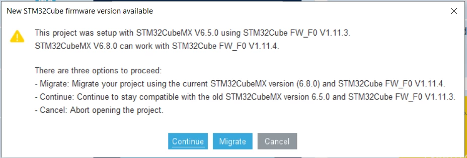

I previously had STM32CubeMX V6.2.1 installed on my machine. I then tried to work on another project that my colleague made and my machine said I would need to “Continue�? or “Migrate�? because I didn’t have STM32CubeMX V6.5.0 installed. So then I updated to the latest Cube MX version (STM32CubeMX V6.8.0) because that’s the only version it would let me update to.

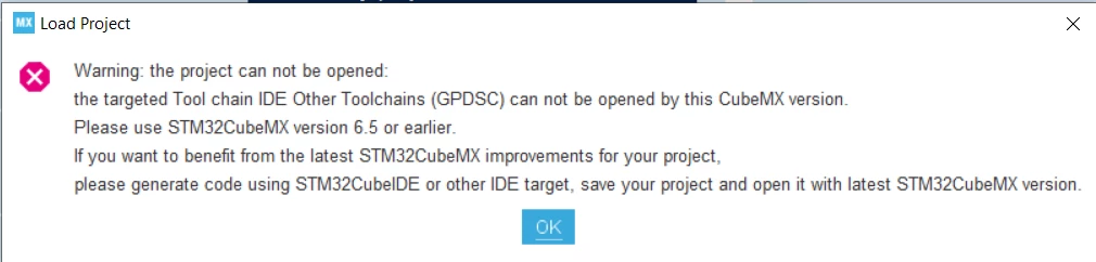

Now feeling like I would have a good chance at victory I opened the same project up and got this:
_legacyfs_online_stmicro_images_0693W00000bj7M7QAI.pngIf I click “Continue�? or "Migrate" I get an error message about a GDSC error in the toolchain and it doesn’t load at all.
So what are my options here? I could figure out how to install version V0.6.5 and it should come good. However this could turn into a nightmare with different workers at our company using different versions to to edit cube files. It would be tedious if they need to download a certain version of STM32 cube for project that they work on. Thoughts?

All developers on a project must be running the same version of CubeMX. You can manually download CubeMX 6.5 from the ST web site and install it. https://www.st.com/content/st_com/en/products/development-tools/software-development-tools/stm32-software-development-tools/stm32-configurators-and-code-generators/stm32cubemx.html
You may then need to download the older version of the F0 lib that the project uses, but that should be do-able from inside CubeMX
This means that you've selected generation of a makefile project (not Eclipse/CubeIDE or Keil or IAR). Is this what you use? IIRC this option has been changed in some recent Cube version. In v. 6.8 it is called "makefile".

JKova.3
JKova.3Author
May 2, 2023 4:15 AM UTC
Thanks for the responses guys. We were using the GDSC file to import the cube project into Visual GDB. I think having different versions of CubeMX installed and keeping a log of which project is using what is probably going to be the best way forward for us (as suggested by Pavel).
