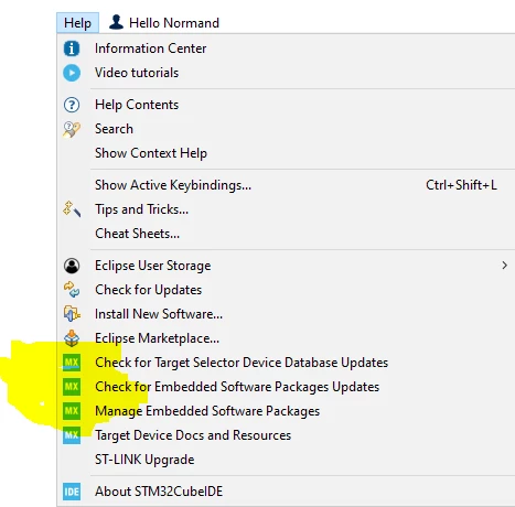

I have an existing STM32L5 project.  I updated to the latest IDE 1.15 which includes CubeMX 6.11.  Opening the project I clicked the migrate option to migrate the workspace and MX to match up with the tools.
I added as pair of precision external crystals (16.0 Mhz and 32.768 kHz) to my design.  I edited the .IOC to enable those 2 external clocks and modified my clock configuration accordingly.
When I click Generate Code, a dialog box pops up for a second and disappears.  No code is generated.
What's wrong?  How can I debug this?

There is a report file also, and that looks right.  The tool just didn't regenerate/update the source.
Grizz
GrizzAuthor
April 15, 2024
Looks like maybe all the package updates did not get applied.
I manually went in and clicked Check for Target Selector updates and Check for embedded software package updates.  Once I did that and restarted CubeIDE, code generation began to run and completed successfully.
I suspect either a silent failure during the update OR the update caused some component mismatches which the update checks corrected.
Either way, it would have been nice to see an error message.  A sub-one second pop-up doesn't do it for me.

It works to me in 1.15.1 after update MCU Package with Manage Embedded Software Package.
