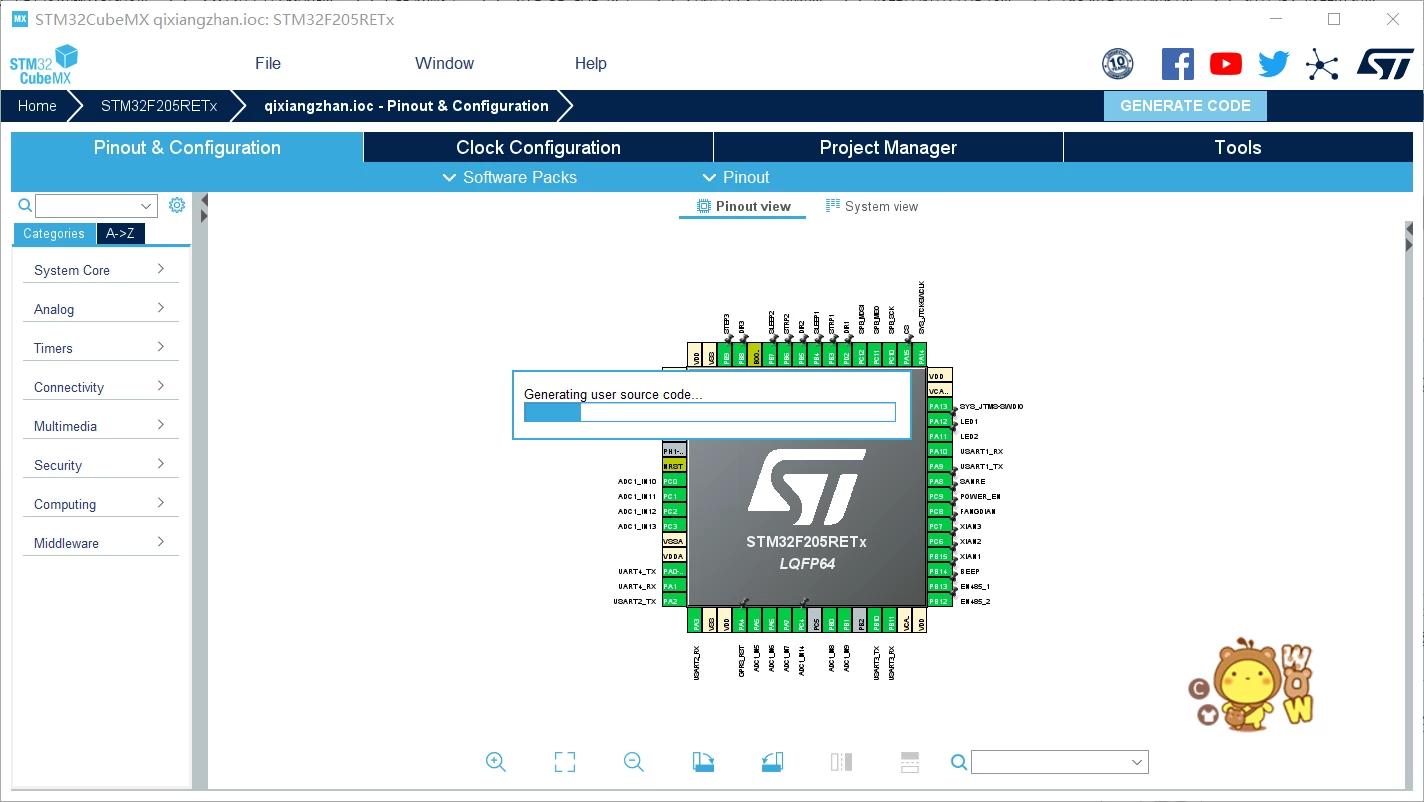

Stm32cube is always stuck in generating keil files
0693W00000BcXUEQA3.pngStm32立方体生�?始终�?��?的开尔文件。�?管你等多久,它都无法�?��?。您必须�?新�?�动计算机�?能�?��?,但很快将�?次�?��?

Hello @�?淼 水​
Thanks for your post,
It's probably a problem linked to Java version, so could you please switch to the latest CubeMX version (6.2.1) and check with it?
I'll be waiting for your feedback,
Khouloud

我试图�?新安装爪哇环境。STM32立方MX也是最新版本。我以为是这个版本的BUG。
故障�??述:打开�?�生�?的几个开机软件工程(当然�?是连续的)一直挂在�?��?��?是固定的时间,�?次生�?工程将被�?��?,软件无法关闭任何�?作无济于事,�?�能通过任务�?�?�强制关闭,但故障�?然�?次打开,�?�能�?新�?�动计算机�?��?正常

Hi @�?淼 水​ ,
As I understood, you still face a problem, right?
I recommend you to use the latest CubeMX version (6.3.0), it uses an embedded jre version different from the one present on your machine to prevent any similar issue, so could you please check with it?
Also, may you please switch to English to well understand you?
Thanks, Khouloud
