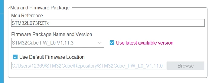

Hi all,
We are about to start evaluation in the following development environment specified by the module manufacturer.
ST Micro NUCLEO-L073RZ
Keil μVision V5 ( V5.29 )
STM32cubeMX (V 6.0.1 ,STM32Cube MCU Package for STM32L0 1.11.3)
Attached files are the project manager screen.

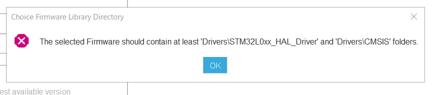

The firmware package version is displayed so that we can select either 1.11.0 or 1.11.3, but selecting 1.11.3 will result in an error.
Could you give me some advice on how to deal with it?

Hello @sss_jpn ,
Could you please download the last version of the STM32CubeMX 6.8.1  from this link.
This version of cube MX integrated the last firmware version of STM32CUBEL0: STM32Cube_FW_L0_V1.12.2.
Please let me know if the issue is solved :).

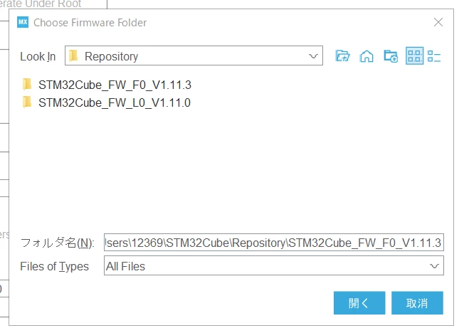

Tesla DeLorean
Guru
July 7, 2023
F0 != L0
