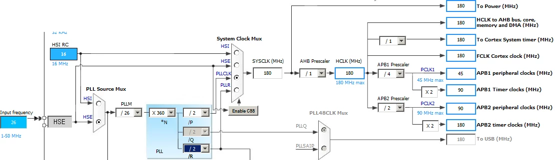

1. The ''Release_Notes.html'' of STM32Cube_FW_F4_V1.6.0 library notice the version
    (\STM32Cube_FW_F4_V1.6.0\Drivers\STM32F4xx_HAL_Driver\Release_Notes.html)
    Moreover, the description of the library's source code show the version at the top.
2. I got the version difference of between the CubeMX library and Standard Peripheral library.

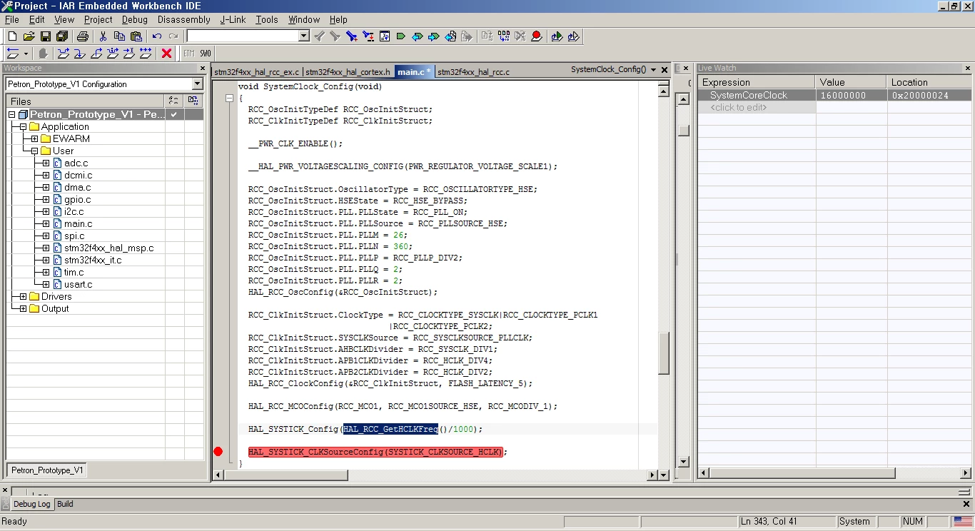

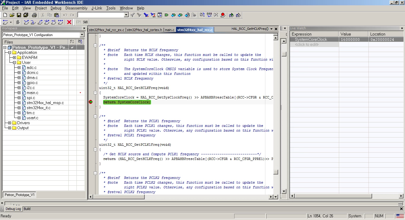

3. The clock configuration bug.
    26MHz HSE but the HAL_RCC_GetHCLKFreq() in the SystemClock_Config() does not display the 180MHz.
    The SystemClock_Config() function in the main() should configure correctly.
    However, the watch result is wrong.
    (The other hands, the result of using Standard library shows 180MHz)

Obviously, this is the bug of STM32CubeMX clock generation.
I upload the 2 files.
- the
original generated system_stm32f4xx.c file
- the
modifiedsystem_stm32f4xx.c file
There are no clock setting code in the SysInit() function.
SetSysClock() function is omitted in the generated code.
