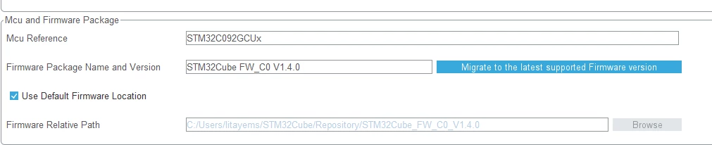

The recommendation is to use the latest version of all stuff: CubeMx, HAL version etc .. If the problem doesn't show in this condition nothing to do from our side because it was fixed in the latest version(s) of the environment.
I invite you to use your CubeMx version but in the Project manager use the latest version of the HAL:
