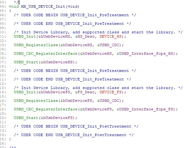

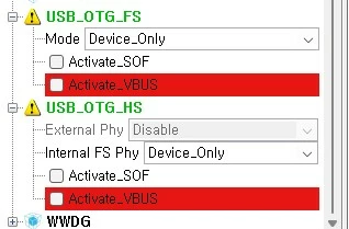

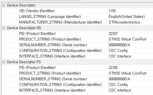

Hello. I'm using EVM board with STM32F407ZGT.
I set up the USB as below to use it as a USB Device. (CDC)
But only one COM port can be found in the device manager on the PC.
I want to know if I can't set 2 usb device or if it's a problem with setting.
Please help me!!

Hello @DJung.3
You need to register two instances with USBD_RegisterClassComposite.
 /* Init Device Library */
 USBD_Init(&USBD_Device, &COMPOSITE_Desc, 0);
 /* Register CDC class first instance */
 USBD_RegisterClassComposite(&USBD_Device, USBD_CDC_CLASS, CLASS_TYPE_CDC, CDC_EpAdd_Inst1);
 /* Register CDC class second instance */
 USBD_RegisterClassComposite(&USBD_Device, USBD_CDC_CLASS, CLASS_TYPE_CDC, CDC_EpAdd_Inst2);
 /* Add CDC Interface Class */
 if (USBD_CMPSIT_SetClassID(&USBD_Device, CLASS_TYPE_CDC, 0) != 0xFF)
 USBD_CDC_RegisterInterface(&USBD_Device, &USBD_CDC_fops);
 if (USBD_CMPSIT_SetClassID(&USBD_Device, CLASS_TYPE_CDC, 1) != 0xFF)
 /* Start Device Process */
 USBD_Start(&USBD_Device);

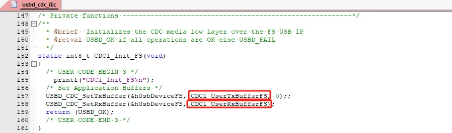

November 13, 2024
Hello, for a USB composite device with two CDC, both CDC eventually call the same CDC_Init_FS function and thus share a single buffer. When both CDCs are transmitting data simultaneously, is there a risk of data loss due to sharing the same buffer?
November 13, 2024
Hi @Mrli110
Have you checked this article How to implement a dual CDC ACM USB device using t... - STMicroelectronics Community  If still having issues, I suggest you starting a new thread.
To give better visibility on the answered topics, please click on "Best answer" on the reply which solved your issue or answered your question.Best regards,FBL
