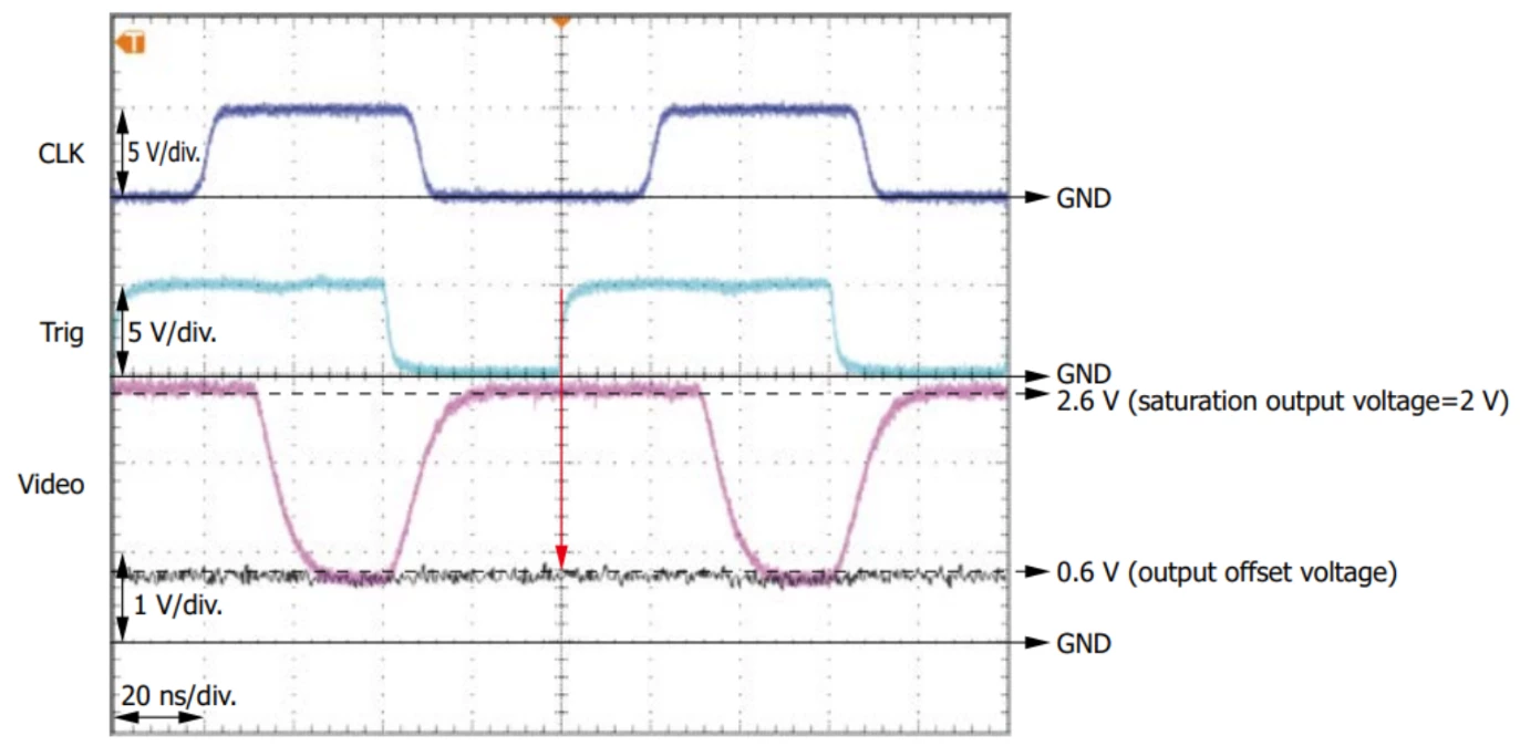

I am using a STM32H723ZG board for a project. In this project I must sample the signal coming from an image sensor that sends the pixel values as pulses with analog amplitudes. This sensor also provides a trigger signal so that the pixels data should be sampled at the rising edge of the trigger signal (an example is shown in the image below).

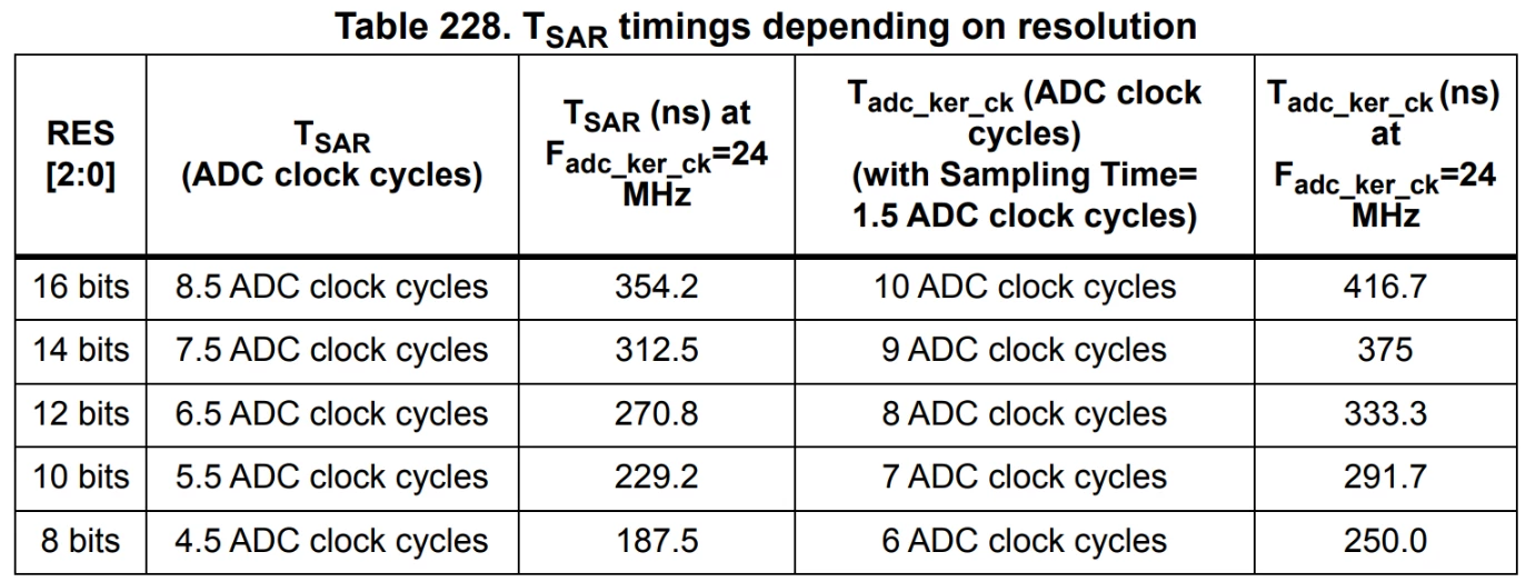

Based on the following table (available in the pg.1014 in the reference manual RM0468:(
0693W00000aHp21QAC.pngThe T_SAR = 6.5 ADC clocks and the sampling time T_SMPL = 8.5 ADC clocks. so the total time for a sampling and conversion operation is 15 ADC clocks. The ADC frequnecy clock is 50 MHz, so the total time would be: 15 ADC clocks = 300 ns. In other words, in continuous mode, the sampling and conversion frequency would be 3,33 MHz.

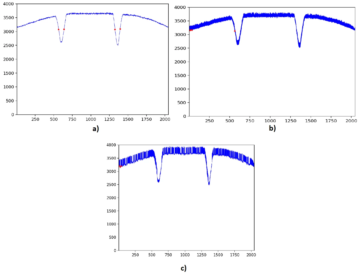

I am also calibrating the ADCs independently before starting them. However, there is a strange behaviour in the sampled signal after uploading the code. When I upload the code, I randomly get any of three possible outcomes:
0693W00000aHp2VQAS.pngEvery time I upload the code to the board, one of the three results (shown above) appears and it does not change over time. The signal that I would like to get all the time is the first one (clause a)). I would like to know why is this happening and how I could fix it. At the beginning, I though that the internal ADC capacitors were not full so it could be a source of error. So I did what I explained before. Then, I though it was because there wasn't enough waiting time for the initialization of the peripherals, but I already tried putting delays of 10 ms after the calibration and initialization of the ADCs (before they start sampling) and the results are still the same.

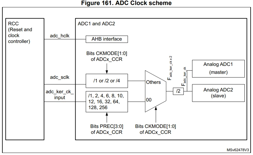

Finally, based on the datasheet, the maximum ADC frequency is 50 MHz. So to reach that value I checked the ADC clock scheme and there is a internal frequency divider that divides the frequency by 2 (see image below). Then, the divided frequency is used by the ADC (pg. 981, reference manual RM0468).
0693W00000aHp68QAC.pngFor that reason I used 100 MHz in the ADC clock Mux in the Clock Configuration Section in STM32CubeMX (which would be the adc_ker_ck input from the image above):

The "result" waveforms, do they display a combined output from both ADCs? Can you display them independently?
CTord.1
CTord.1Author
February 28, 2023
Hi @Community member​,
Yes, it looks like both ADCs follow the same pattern, but one has a different offset relative to the other and sometimes they have the same offset (as in the image of clause a)). Is it possible to always have the same offset for both?

waclawek.jan
February 28, 2023
Offset may be result of different calibration. You can observe the calibration results in the CALFACT registers. You can even change them, although wouldn't recommend that, and I'd personally strive to find the primary source of the differences, if there are any.
Note, that the primary requirement for any serious ADC work, including calibration, is rock stable VREF+ against VREF-/VSSA (which includes VREF+ source, VREF+ and VREF-/VSSA routing including its "quietness" and decoupling from digital VSS, recommended or more decoupling capacitors' combo between VREF+ and VREF-/VSSA at the absolute minimal distance, etc. We are talking millivolts or better here. VREF+ is subject to similar pulsed current consumption from the switched capacitors as ADC inputs are, and its impact on ADC measurement results is huge.
