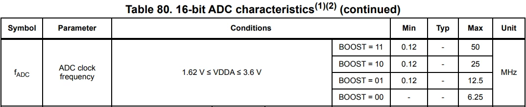

I am using a STM32H723zg board for a project and I must read analog signals so I am using one 16-bit ADC. Based on the datasheet of this microcontroller serie, the maximum ADC clock frequency is 50 MHz for BOOST = 11.

Best answer by S.Ma
going To ADC (MHz), the ADC usually has a clock prescaler to scale it down.
Probably you will use 96/2 = 48MHz then.
If you want exactly 50 MHz, you will either cranck up the source to 100MHz or use a different clock source (the shown multiplexer above).

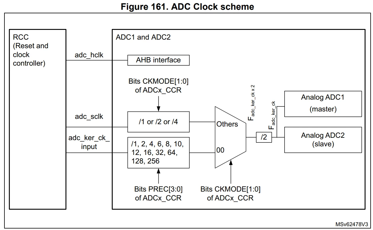

Ghofrane GSOURI
February 20, 2023
Hello @CTord.1​
Please check the RM0468 paragraph 28.4.3 ADC clocks and Figure 230. ADC clock scheme for more details .

CTord.1
CTord.1Author
February 20, 2023
Thanks for the answers. I reviewed the diagram in the reference manual:
0693W00000aHEhRQAW.pngThe input clock is divided by 2 after the multiplexer. Hence, If I undestood correctly, with a prescaler=1 and setting 100 MHz in STM32CUBEMX, the input clock frequency will be divided by 2 after the multiplexer and the ADCs will use actually 50 MHz in this case. Is this reasoning correct? I think is what @S.Ma​ mentioned
