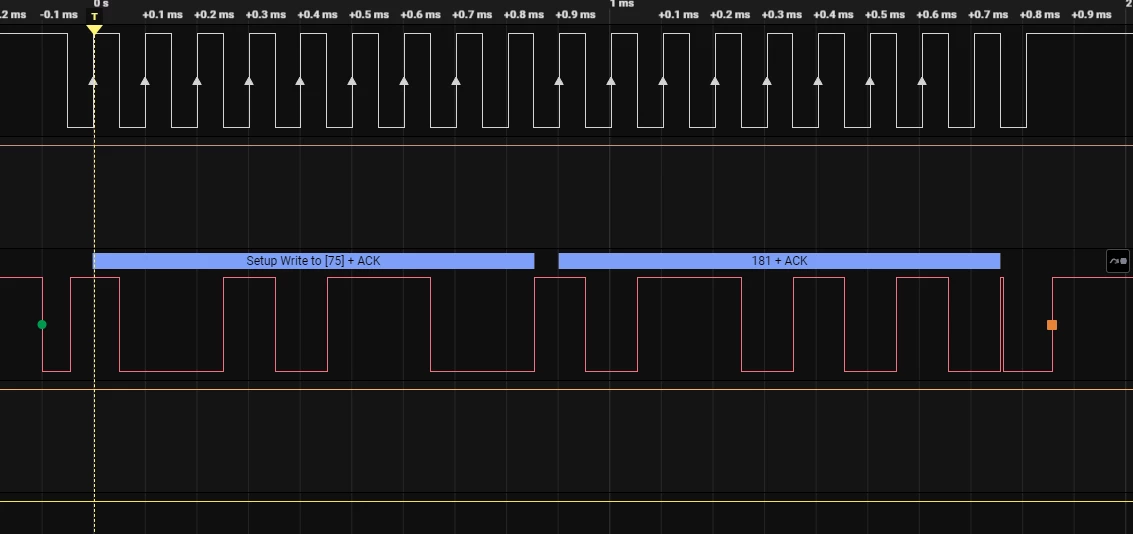

I have connected logic analyzer to the I2C pins and see the following:
Which is not correct. I expect to see 150+ack and 140+ack but instead I see 75+ack and 181 + ack.

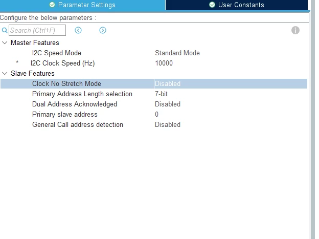

My I2C configuration on CubeMX:

Pavel A.
April 14, 2022
Check return value of HAL_I2C_Master_Transmit.
If it is HAL_OK, the device likely replied ACK after the address, then the issue is with your analyzer. Else ...
April 14, 2022
150 is 2*75. The 7-bit address (reported by the scope) is 75, while the 8-bit address is 150. No issues with this byte. Datasheets vary between specifying 7-bit or 8-bit (7bit shifted left by one bit plus R/W bit) addresses.
Not sure on the second bit. Micros are not prone to erratic behavior. There is certainly an explanation somewhere.
