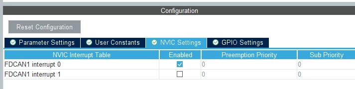

i'm trying to set up a new project with CAN in Interrupt mode. Therefor i generate a project with stm32cubemx and enabled the interrupt 0 for fdcan1 and also in the NVIC-settings the Interrupt is enabled:0693W00000AN0JsQAL.pngIn polling mode, i can receive Frames and got no problems. When i try the to use the NVIC, the ISR-Adress is wrong an it don't jump to the generated "FDCAN1_IT0_IRQHandler". The Controller jumps to an undefined Adress:0693W00000AN0JxQAL.png

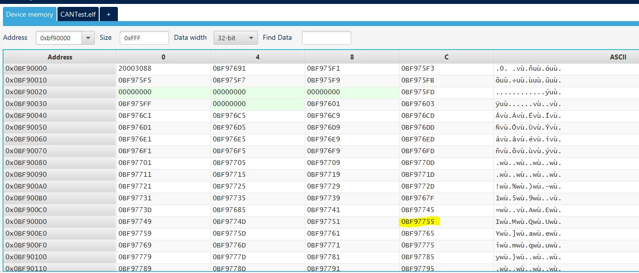

I've tried to get some more informations about the vector table. The ISR for fdcan_it0 should be in 0xbf900dc, the function of NVIC_GetVector gives me the Adress 0xbf97755.

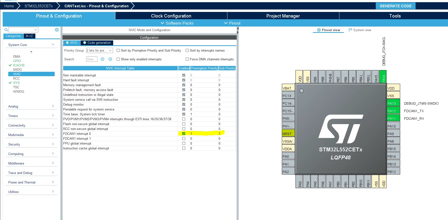

i tried to get any interrupt working today but without success. Therefor i started with a new empty stm32cubemx project, selected the STM32L552CEx controller and enabled the fdcan1 with interrupt on line0 0693W00000ANA4xQAH.png

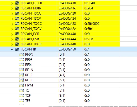

Up there it worked. When i send a canframe from an external system i see an interrupt pending.
0693W00000ANAFRQA5.pngBut the controller don't enter the generated function from the cubemx

My guess is that something is wrong with the config of the interrupt vector table. VTOR gives me the baseaddress of the tabel, thats 0xBF90000. In the register starting from 0xBF90010, should be the addresses for the specific interrupt. The CAN ISR is the Block 0xBF900DC and thats not the function for the isr.

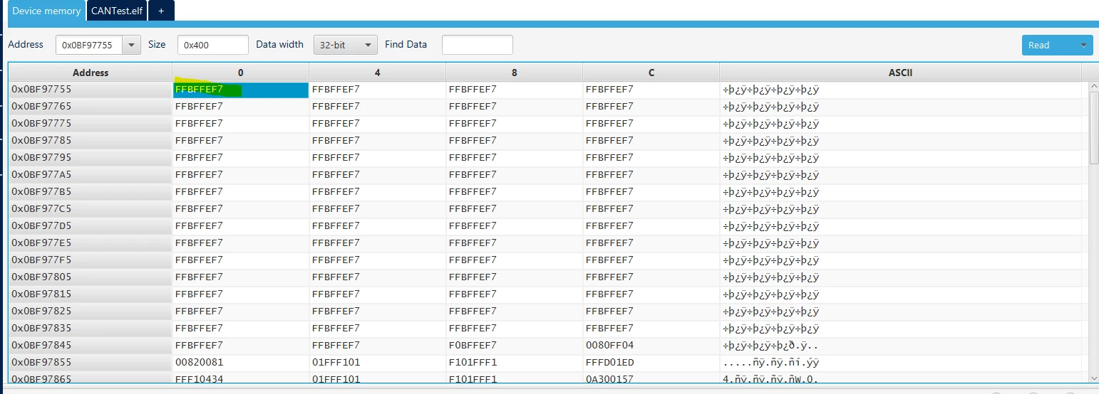

0693W00000ANAOxQAP.pngThis address jumps outside the code 0693W00000ANANbQAP.png
It ends up by the error:
Break at address "0xbf97754" with no debug information available, or outside of program code.
I hope you can reproduce the problem or have any idea for the config of the isr table.

So, i get it working right now.
A deeper look in the hex files shows, that the interrupt table is based in the 0x8000000 Adress. So i added
 SCB->VTOR == 0x08000000;
This solved the problem.
