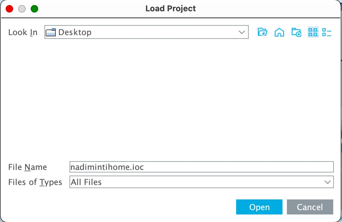

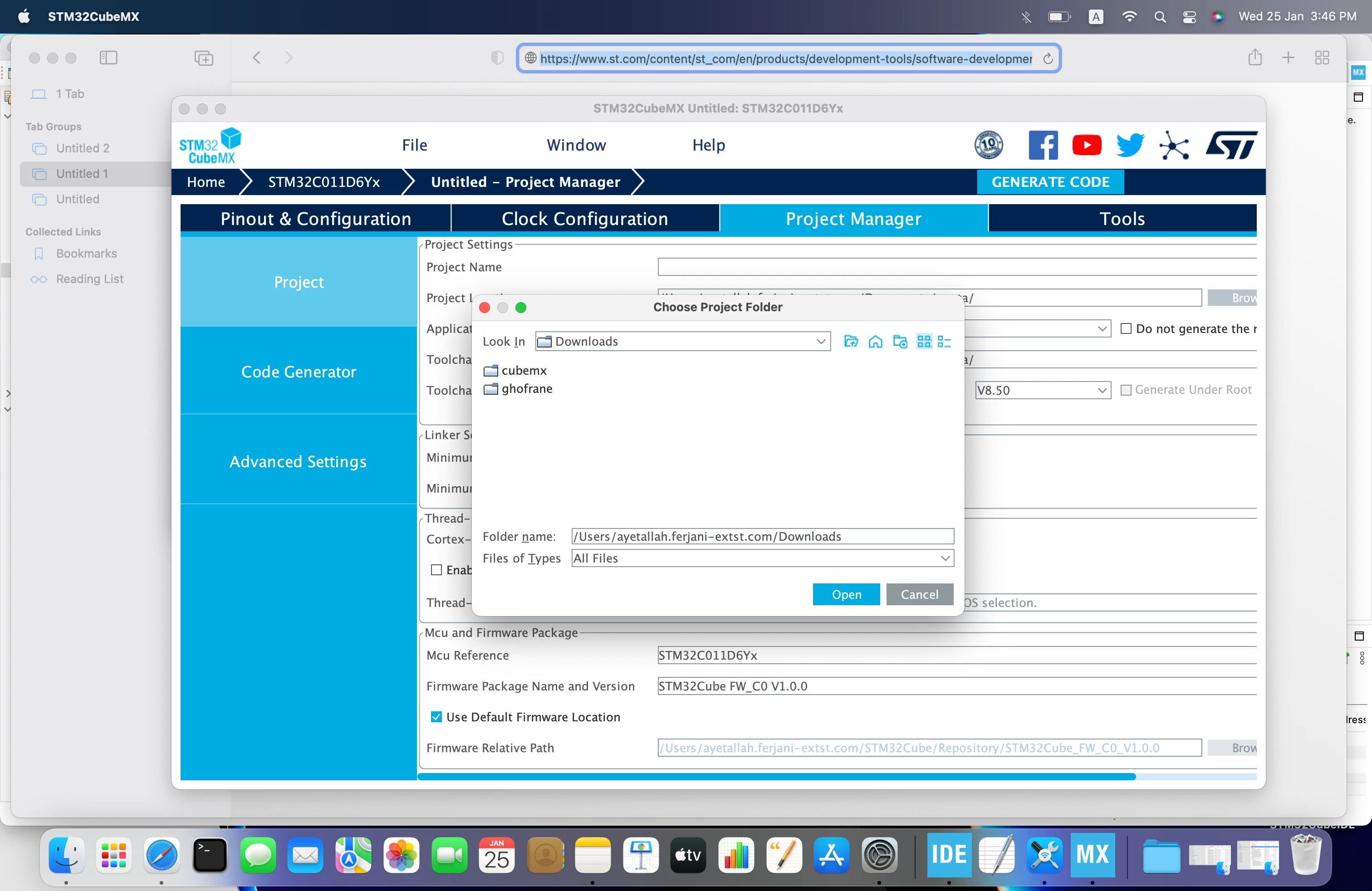

STM32 CubeMX on Mac (M1, Montery 12.6) does not seem to be able to display folder/file structure when I try to browse for saving the project at a specific location. Second, the 'Save As' does not allow me to change the project name to a new one.
  • January 25, 2023
  • 8 replies
  • 5661 views

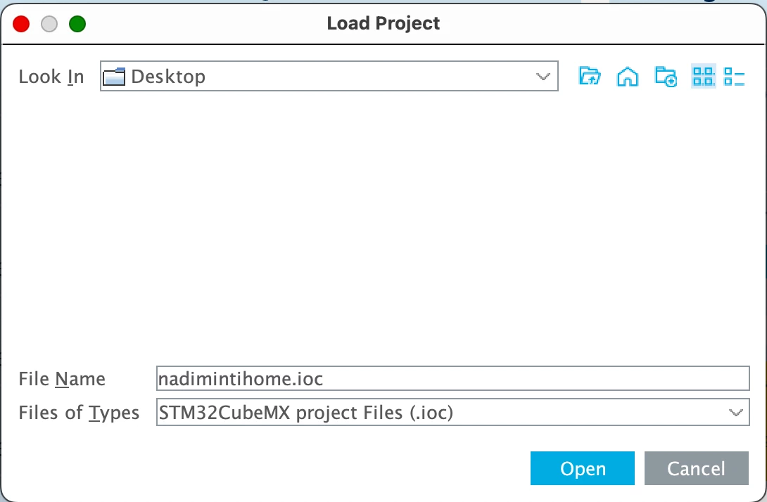

The same happens when I try to open a project from the 'Other Projects -> Open' button.

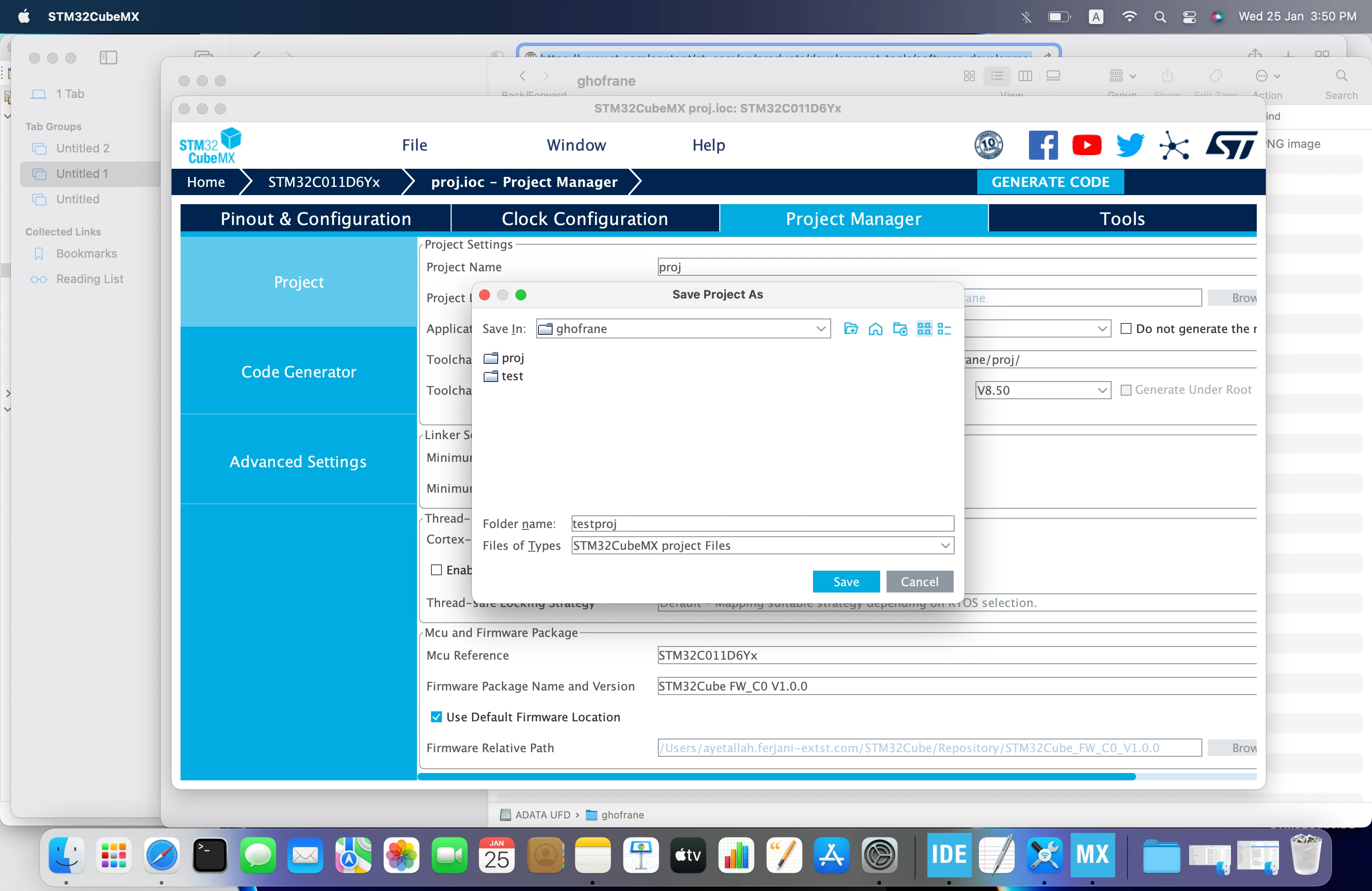

Hi @Ghofrane GSOURI​ ,
Thanks for the reply. I have updated CubeMX and it is still the same. (screenshot attached).

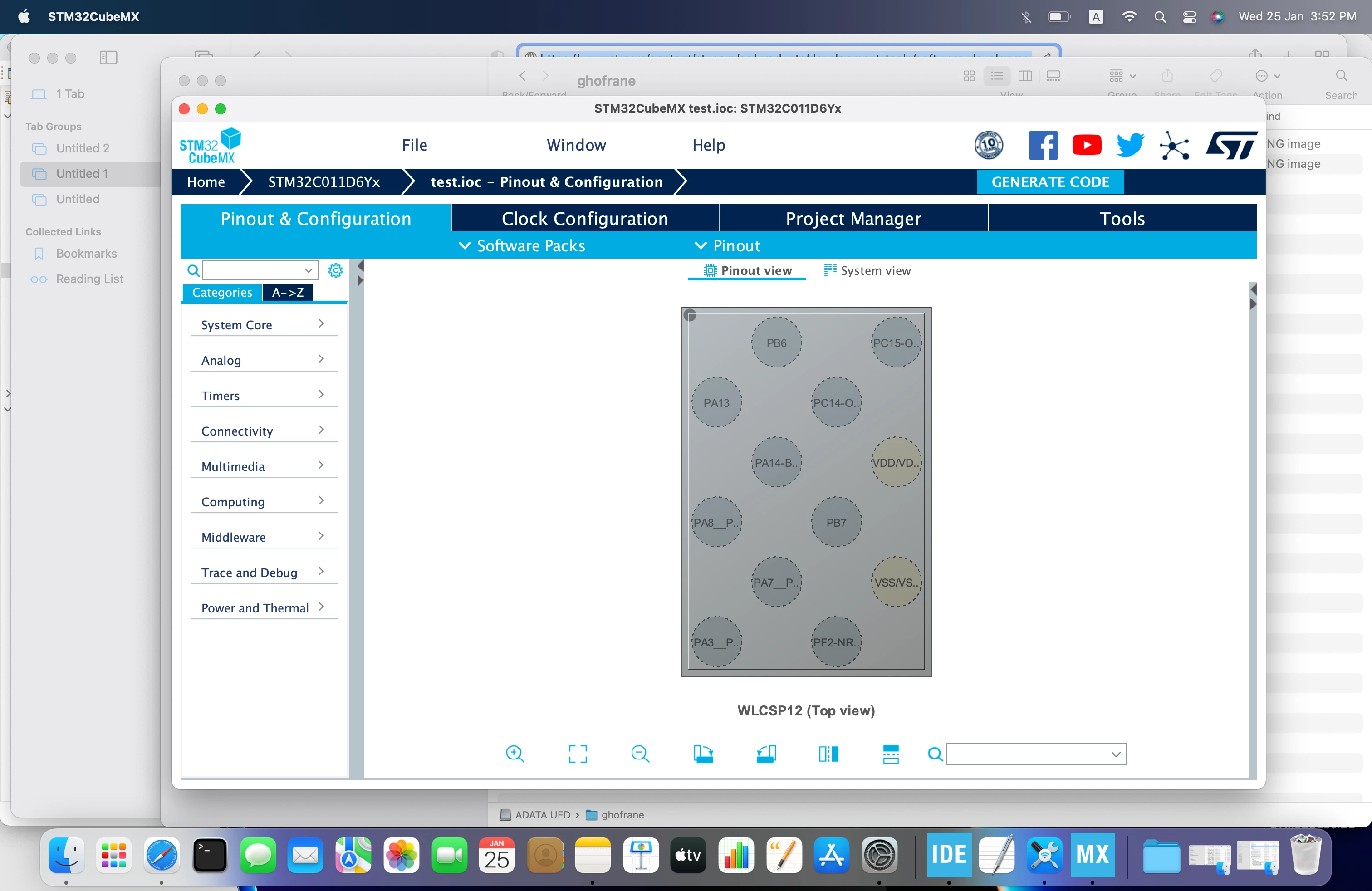

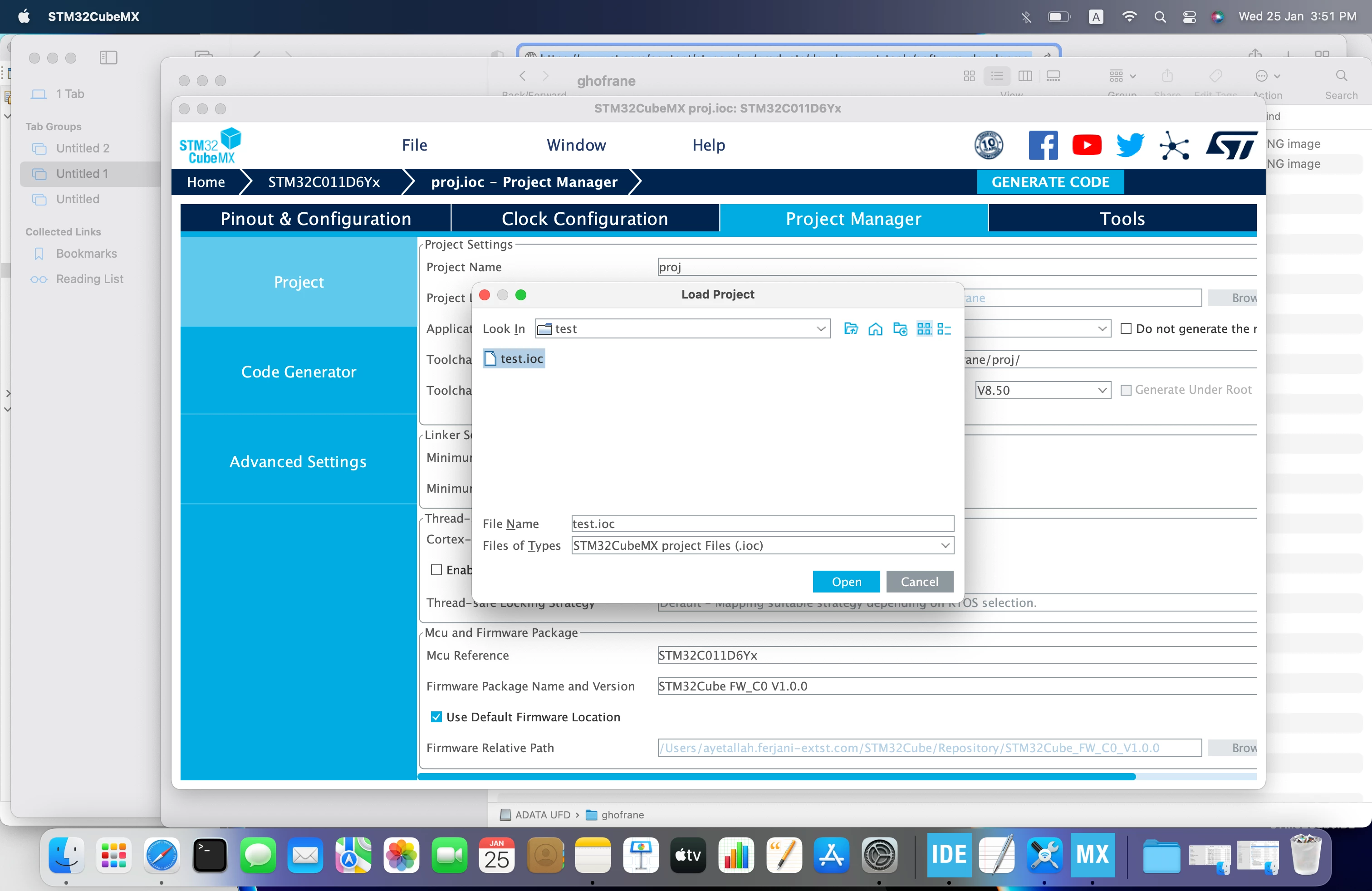

Hello @MJ042​
Actually I tried to reproduce the issue using the latest version Cubemx 6.7.0 but it works fine from my side .
I create a project I save it at a specific location that I choose
I changed the project name using the "save as "
0693W00000Y9933QAB.png0693W00000Y992tQAB.png0693W00000Y992eQAB.png0693W00000Y992KQAR.png
Thx
