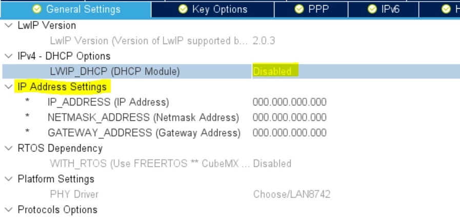

Hi, I use LWIP to establish a connection, We want to change the IP address, how can I update IP?
 tcpip_init( NULL, NULL );
 /* IP addresses initialization without DHCP (IPv4) */
 IP4_ADDR(&ipaddr, IP_ADDRESS[0], IP_ADDRESS[1], IP_ADDRESS[2], IP_ADDRESS[3]);
 IP4_ADDR(&netmask, NETMASK_ADDRESS[0], NETMASK_ADDRESS[1] , NETMASK_ADDRESS[2], NETMASK_ADDRESS[3]);
 IP4_ADDR(&gw, GATEWAY_ADDRESS[0], GATEWAY_ADDRESS[1], GATEWAY_ADDRESS[2], GATEWAY_ADDRESS[3]);
 /* add the network interface (IPv4/IPv6) with RTOS */
 netif_add(&gnetif, &ipaddr, &netmask, &gw, NULL, &ethernetif_init, &tcpip_input);
 /* Registers the default network interface */
 netif_set_default(&gnetif);
 if (netif_is_link_up(&gnetif))
 /* When the netif is fully configured this function must be called */
 netif_set_up(&gnetif);
 else
 /* When the netif link is down this function must be called */
 netif_set_down(&gnetif);
I used to remove the link and reconnect, it doesn't work. is there any ideas?

Hello @YiKai​
You need to Disable the LWIP_DHCP then under IP Address settings you can update it.
Please use the latest CubeMX release (6.0.1) because there's an issue related to LWIP in the previous version (5.6.1).

Thanks, I use the latest CubeMX release, it's work.
