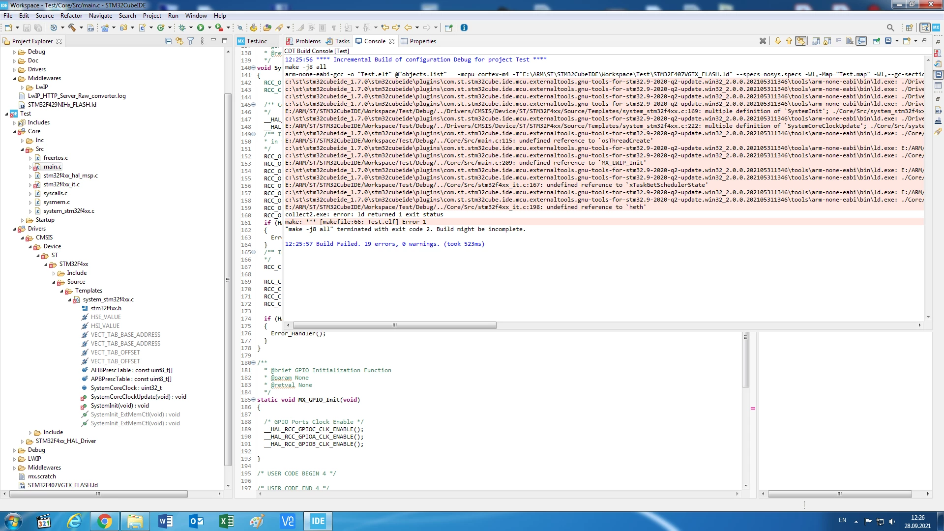

STM32 Cube IDE - cubeMX includes multiple source files that results in multiple definition errors
Time to time cubeMX configurator includes c files in multiples, which I can clear by deleting one of them. But cubeMX insists adding multiples again in each regeneration. In freshly generated projects it doesn't do so. That issue appears only when I attempt to make a revision using the cubeMX configurator.
I am using cube IDE version 1.4.2 and :
cube MX
Version: 6.0.1-RC3
Build: 20200810-1643 (UTC)
In the attached image you can see multiple includes of system_STM32F1xx.c file. Project builds smoothly when I delete one of them.

did you generate code for other IDEs before generating for CubeIDE?
I had similar problem when generated project for Keil and then generated for cubeMX. Maybe starting a new clean project and adding your source helps.

Thanks for your attention prain. No, the code has been generated using cube IDE. Newly created projects do not have such a problem. After several editions and modifications using cubeMX configurator -not stand alone one, this is done under the hood of cube IDE- all of a sudden, it starts to create duplicate files under src, and cmsis/template folders.
I still have this phenomena, but I learned to survive by deleting one of the multiples. Until I discovered where to find the the multiples, I had been regenerating the complete project from scratch, which was a painful task.
I am disappointed that somebody from ST, haven't read and commented on that. There were some threads in the community on this topic, recommending editing make files etc, but no solution related to the cubeIDE tool.

So I have been surviving by deleting the duplicate file in drivers/CMSIS/Device/ST/STM32F1xx/source/Templates/ folder. (In case of system_stm32f1xx.c file, but it happens in other CPU types, also.)

appends also with recent IDE versions, is not a solution but works
"Exclude from build" the template file
