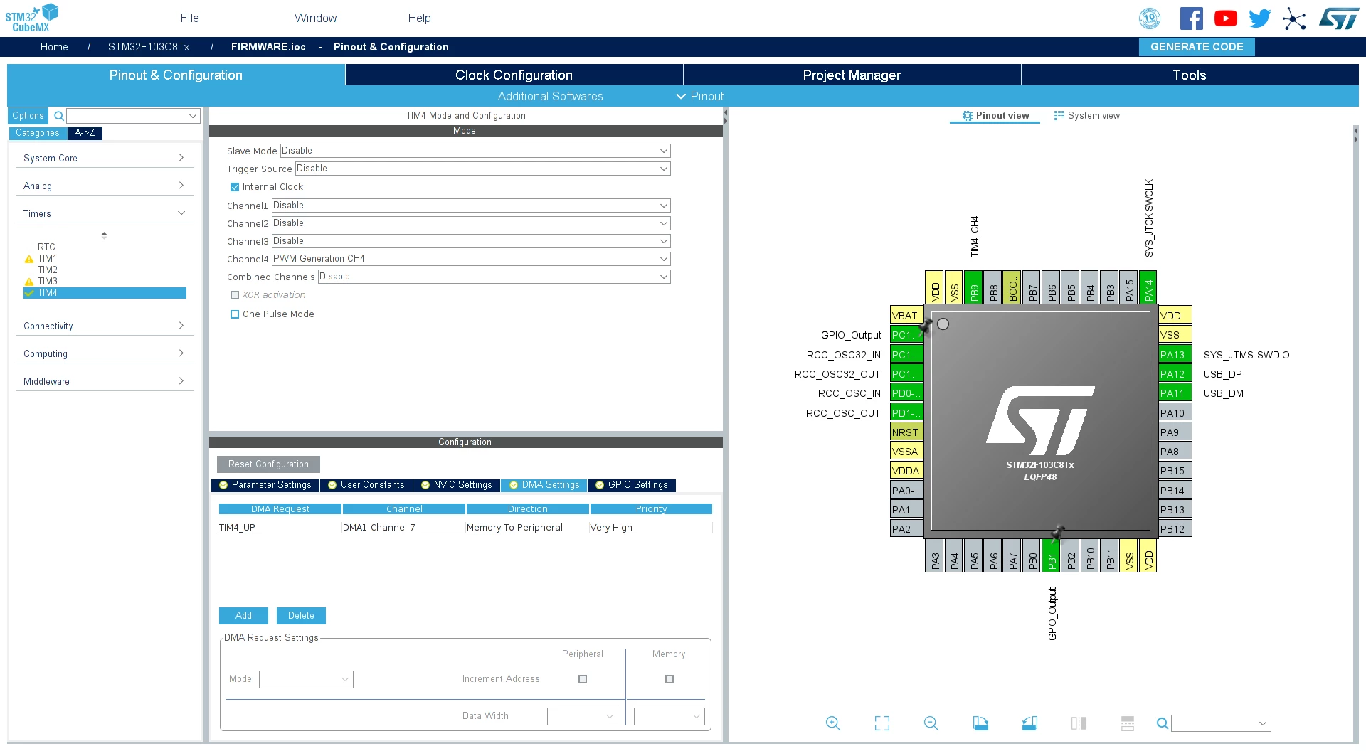

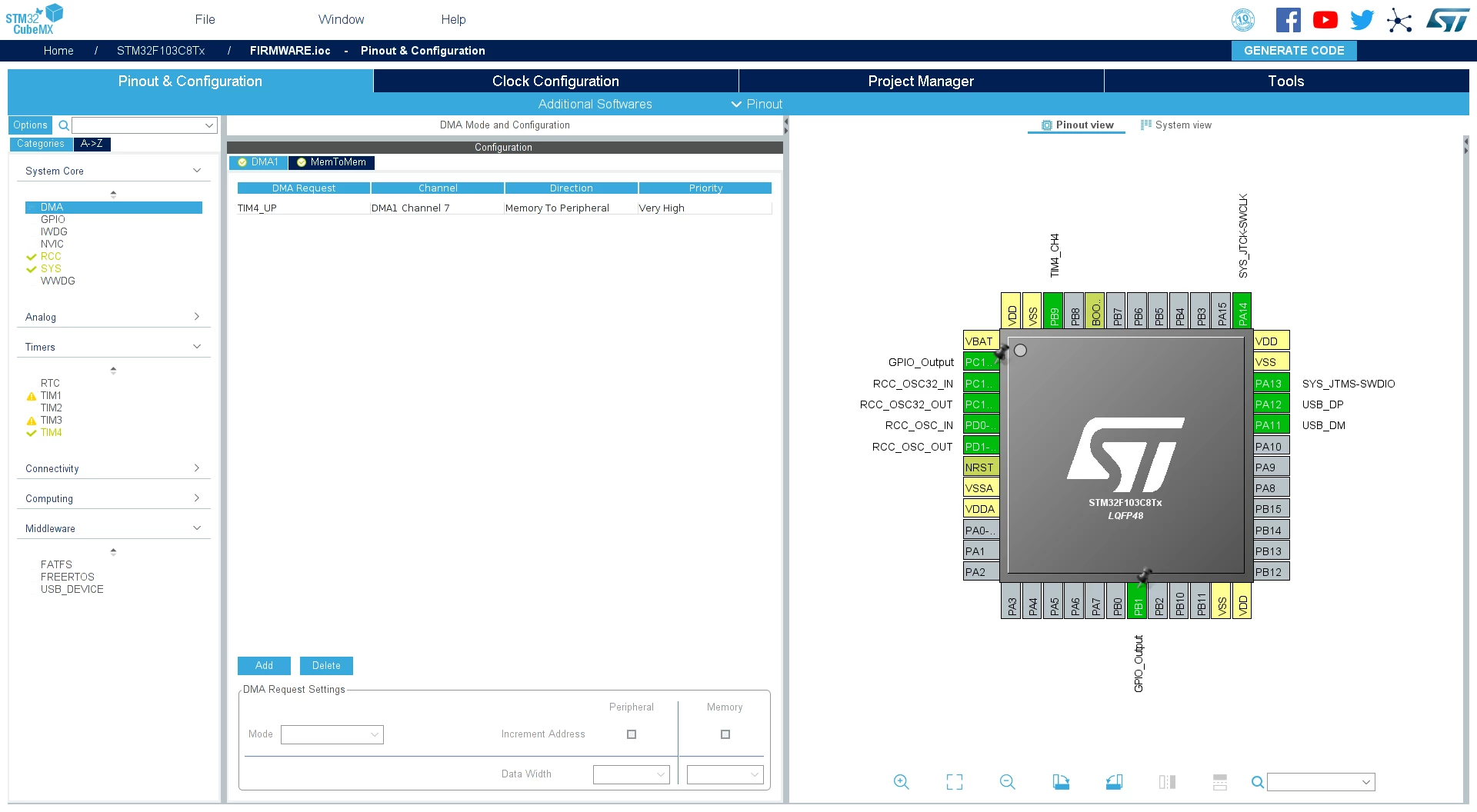

To create something clean, I have configured STM32CubeMX and generated fresh files (configuration in attached documents below).

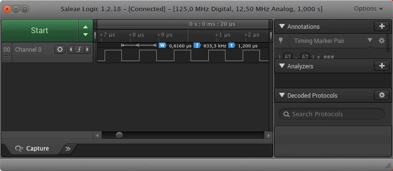

If I test my PWM with fixed frequency and fixed duty cycle, everything is working (without DMA). I have not modified files, just added this line to start the PWM:
HAL_TIM_PWM_Start(&htim4, TIM_CHANNEL_4);
Result as expected:

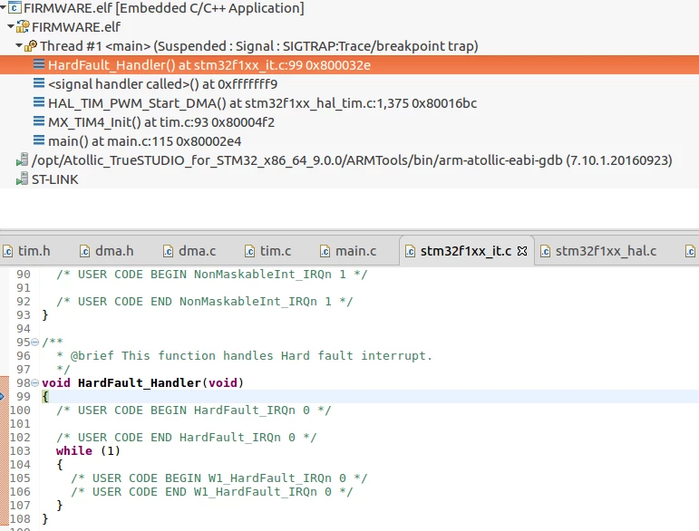

More particularly, it seems to crash at this moment:
/* Set the DMA error callback */
htim->hdma[TIM_DMA_ID_CC4]->XferErrorCallback = TIM_DMAError ;
Maybe I am missing to do something...

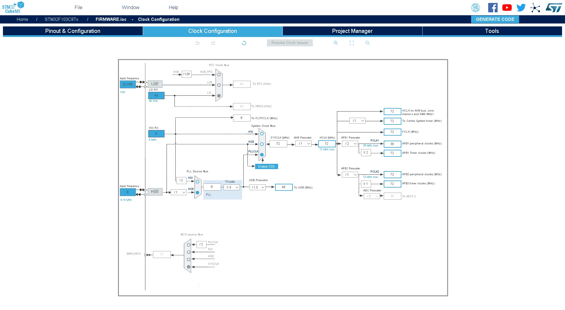

see your external crystal frequency is setup correctly if it is wrong then hard fault occurs in MCU.
Geo En
Geo EnAuthor
Jan 5, 2019 12:19 PM UTC
Thanks for you answer, but my problem does not seem to be related to any crystal frequency error as everything is working correctly except when I call the DMA.
My crystal seems to work correctly
And STM32CubeMx is set correctly:

Jan 5, 2019 2:33 PM UTC
Likely missing an interrupt handler.
Consider also stack size, and errant pointers.
Use a better fault handler, and look at the faulting instructions/registers.

I faced exactly the same issue on BluePill STM32F103CB, when trying to generate a sawtooth on PB9 (Timer 4 CH4 PWM) for ADC dithering (but that's another story).
From my understanding, CubeMX generates wrong code line 76 of tim.c
It is
  1. __HAL_LINKDMA(tim_baseHandle,hdma[TIM_DMA_ID_UPDATE],hdma_tim4_up);
whereas it should be:
  __HAL_LINKDMA(tim_baseHandle,hdma[TIM_DMA_ID_CC4],hdma_tim4_up);
Once this line manually fixed, the bus fault disappears.

Something is not clear, in stm32cubeMx: For channel 4 we have only TIM4_UP for DMA request. But for channel 3, we have TIM4_UP and TIM4_CH3 (we need to use this one). Most of the time, stm32cubeMx is really good to work quickly. But in cases like this one, I have read a big part of the datasheet and the library to understand the problem... If I need to do this, I can configure registers myself so I don't need a wizard ... Maybe one day, there will be some descriptions in stm32cubeMx and not only drop down menus with no sense ...

Yep, this is exactly the problem. We don't set the good pointer. So the library use a pointer = NULL and try to execute a function = NULL...
The problem is: we don't have the possibility to use the good pointer in stm32cubeMx. Maybe because that's impossible physically, or maybe because I have made a mistake, or maybe it is a bug in cubemx. Who knows? as there is no description at all in this wizard...
