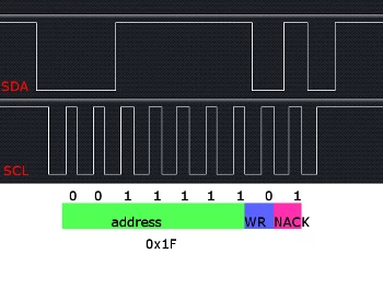

I've been working with ST HAL libraries for an STM32F030R8T6, using the NUCLEO board, and I'm having some problems with the I2C API. Probably it's a configuration issue but for the love of me, I can't find it. The problem: I call the function
HAL_I2C_Master_Transmit_XX
with address 0x3E. I attach a logic analyzer to the output to check the lines, and the address does not match. The address I see on the line is 0x1F. My main test code is the following. (Just to reproduce this situation) It is a direct copy from the NUCLEO examples. I skip over the

This code, when examining the output with the logic analyzer, generates the following SDA/SCL sequence. 0690X00000605MkQAI.png The Theory: I went down to the ST code generating the address.

And from the
http://www.st.com/web/en/resource/technical/document/reference_manual/DM000319pdf
, section 7.2, Control Register 2 (I2C_CR2):
Bits 9:8 SADD[9:8]: Slave address bit 9:8 (master mode)
This bit are don’t care
Bits 7:1 SADD[7:1]: Slave address bit 7:1 (master mode)
These bits should be written with the 7-bit slave address to be sent
Bit 0 SADD0: Slave address bit 0 (master mode)
This bit is don’t care
I understand that on 7 bit address mode, the CR2 bits used to generate the address are SADD[7:1] neglecting the value of SADD0. But the ST HAL driver seems to write the value directly (with no shifting at all), hence the ''transformation'' from 0x3E to 0x1F: I2C_CR2[7:0] = 0x3E I2C_CR2[7:1] = 0x1F This would be fine for 10 bit addresses, but I'm having trouble with 7 bit. I tested using an I2C temperature sensor (address 0x40). And I can't read anything at all using 0x40, but everything is fine and dandy when using 0x Could somebody please point me to any configuration flag that I may have missed? Salut! #i2c #hal #cubemx #stm32

Posted on February 12, 2016 at 16:09
ST, like many others, represent the 7-bit address as the high order 7-bits exactly as they appear on the bus, and the low order R/W bit is determined depending on the nature of the interaction. In these types of systems the address becomes (DATASHEET_ADDR << 1)

Posted on February 15, 2016 at 10:00
Thanks for your response.
I was already shifting the address, but was not sure if this was the ''correct'' behaviour.

Posted on February 15, 2016 at 11:20
No problem, you just have to watch the system and device data sheets and implementations very carefully. People have represented the 7-bit address in all manner of ways over the decades, so I always double check what the data sheet says, and what the timing diagram illustrates, and then contrast that with how it is handled in the software side driver stack.
