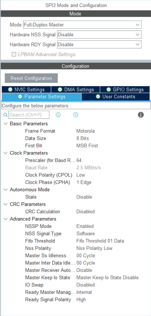

And here is my pin configuration:
I am trying to measure the clock signal with an oscilloscope that has a high enough BW to capture it, yet it seems that a clock signal is not generated.
I am not sure if there is something wrong with the way I initialize my device, or if there is another issue.

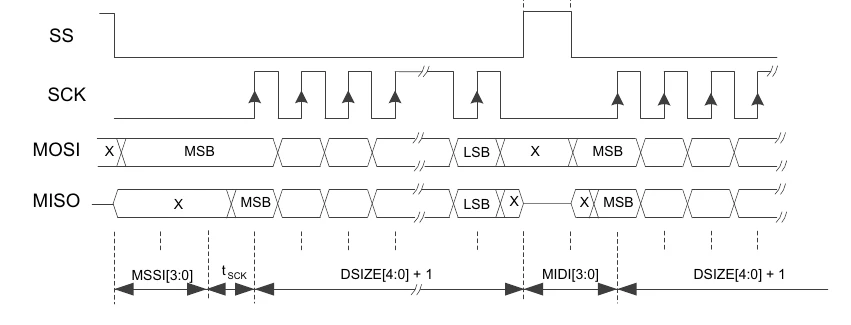

AScha.3
June 8, 2023
clk ? i see no sending of data - clk comes only with data bits to send 
see:
