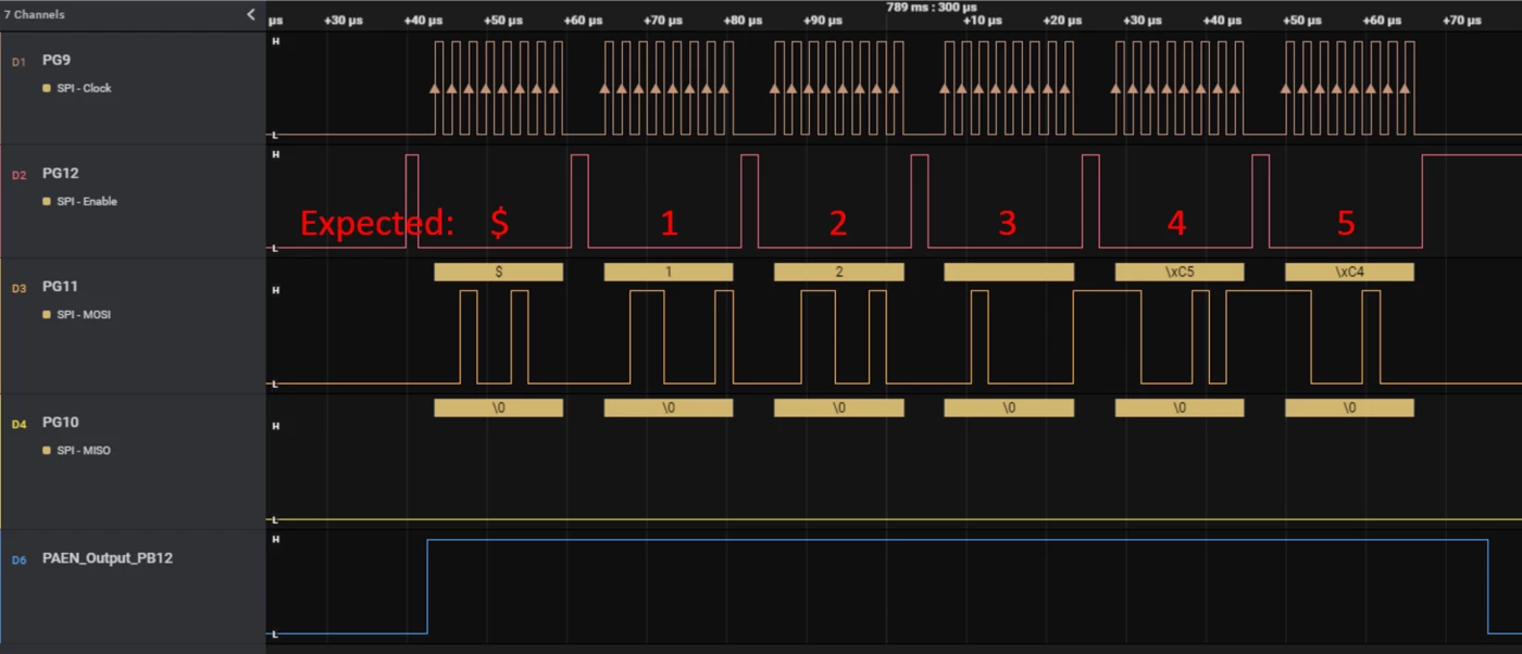

SPI + DMA only transmitting half of total bytes sent?
- 6 replies
- 2655 views
I am trying to setup SPI communication via DMA on the STM32L4S9AII6 MCU. It seems to be half working as you see in the image "SPI Bug". In this test I am sending a string of 6 bytes. As you can see, only the first half make it out of the MCU alive, but the MCU is obviously trying to send the full 6 bytes. This is over the SPI3 peripheral. Also note the PB12 signal at the bottom of the "SPI Bug" image attached. This is a GPO pin that I assert high when the "HAL_SPI_TxHalfCpltCallback" callback function is called. Likewise, I de-assert the same pin low when the "HAL_SPI_TxCpltCallback" callback function is called. Not sure why the half-transfer complete callback function is getting called at the beginning of the transfer. Maybe that is a hint as to what is wrong here.
I am also successfully using UART1 + DMA where I am consistently able to send messages with many bytes.

Here is how I have SPI3 configured. Note that I have adjusted many settings with no avail.

Is this a bug anyone else has seen before?
