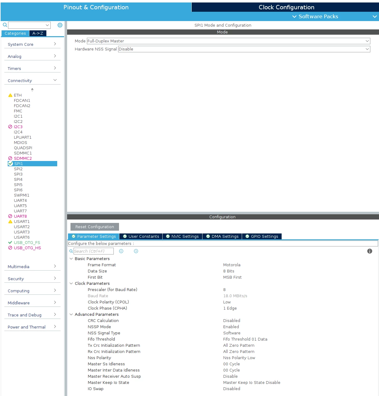

I have used STM32CubeMX to generate the configuration required to use SPI1 with DMA for a nucleo H743ZI2 board:
Then, I generate the code as a Makefile project and modify the main function to have:

I inspect pin PA5 (as STM32CubeMX indicates is the SPI1 SCK) with my oscilloscope and I see nothing. What is it failing?

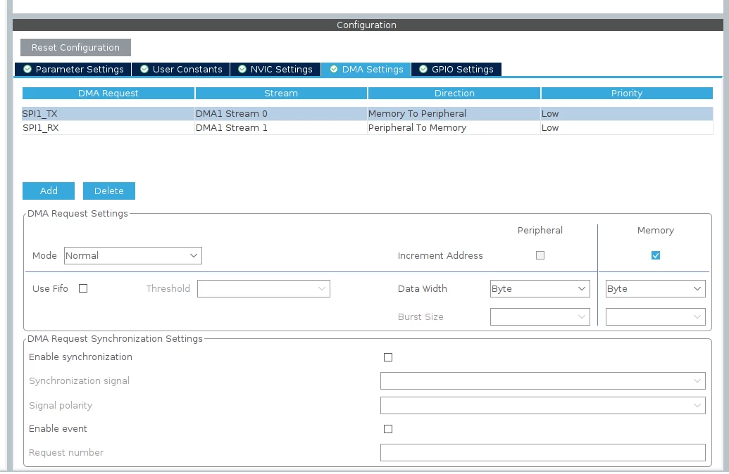

Here are the initialization functions:

static void MX_DMA_Init(void)
 /* DMA controller clock enable */
 __HAL_RCC_DMA1_CLK_ENABLE();
 /* DMA interrupt init */
 /* DMA1_Stream0_IRQn interrupt configuration */
 HAL_NVIC_SetPriority(DMA1_Stream0_IRQn, 0, 0);
 HAL_NVIC_EnableIRQ(DMA1_Stream0_IRQn);
 /* DMA1_Stream1_IRQn interrupt configuration */
 HAL_NVIC_SetPriority(DMA1_Stream1_IRQn, 0, 0);
 HAL_NVIC_EnableIRQ(DMA1_Stream1_IRQn);

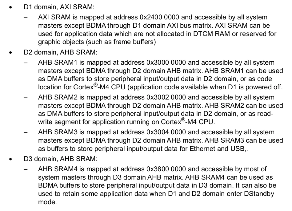

Feb 10, 2023 6:27 PM UTC
I have read this in the datasheet
So it seems DMA buffers can only be located at specific regions.
