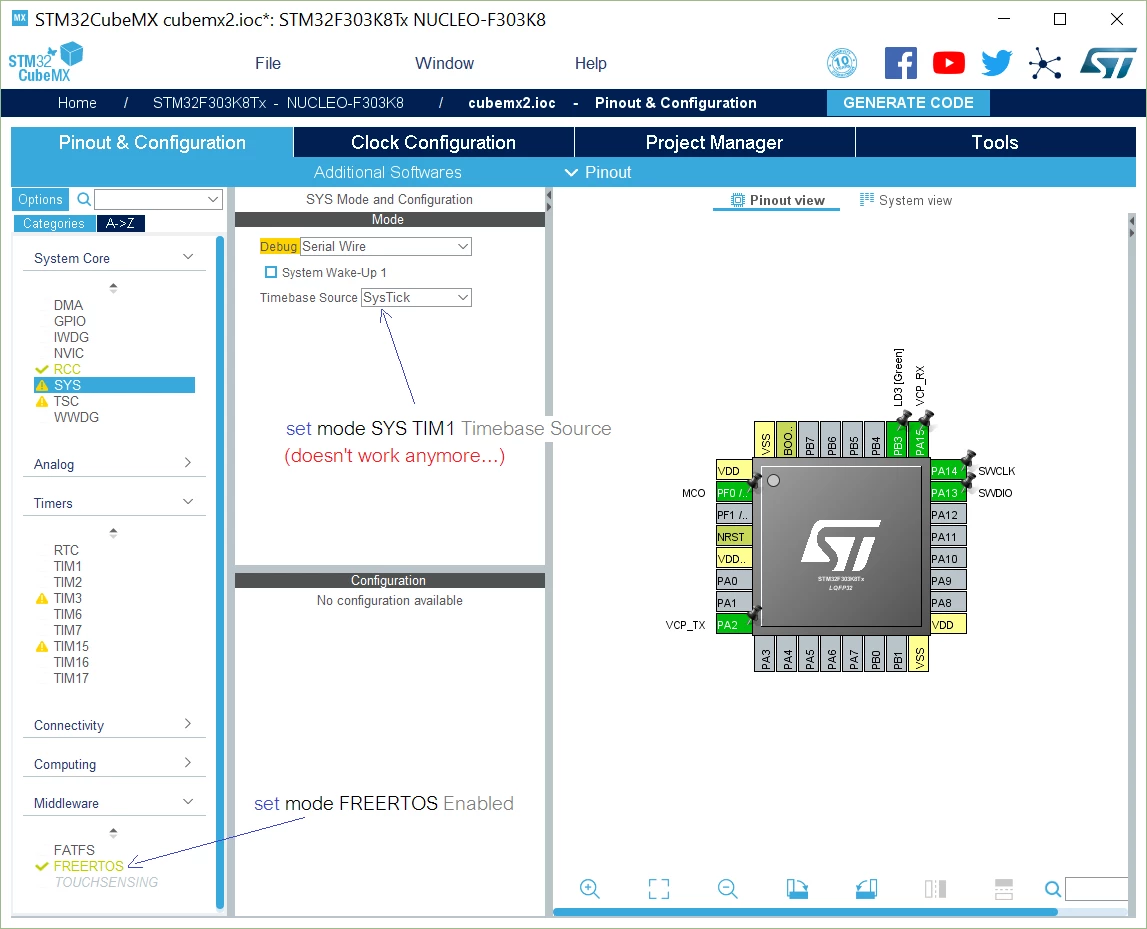

I use the CubeMX command-line interface. Normally I put my script in a file, and run it like this:
java -jar "C:\path\to\STM32CubeMX.exe" -q "C:\path\to\myscript.txt"
But before doing that, I test the script commands one-by-one in the interactive mode. That means, I start up CubeMX with the command line interface and I can see visually what happens upon each command I enter:
java -jar "C:\path\to\STM32CubeMX.exe" -i
The first command I usually issue then is to load an existing `ioc-file`:
config load "C:\path\to\my_cubemx_proj.ioc"
Then I issue the following command:
set mode FREERTOS Enabled
This works. I can see immediately the green checkmark appearing next to `FREERTOS` in the Middleware section. The next thing I do is changing the Timebase Source in SYS from `SysTick` to `TIM1`:
set mode SYS TIM1 Timebase Source
This used to work in the previous CubeMX version. But in CubeMX5 it doesn't have any effect. The following image illustrates what happens:
Best answer by Kristof Mulier
I discovered the answer (through trial and error).
set mode FREERTOS CMSIS_V1
set mode SYS TIM1
The main problem is this:
The CubeMX documentation explains how the `set mode` command works:
set mode <Periph> <Mode Name>
but nowhere can I find the values I should fill in for the placeholders.
set mode SYS TIM1
