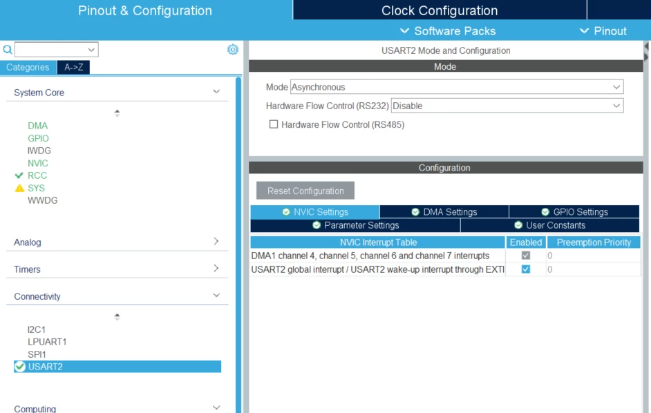

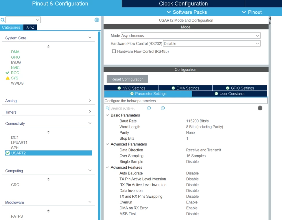

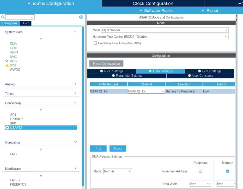

I'm trying sending message over UART with DMA with following code and CubeMX configuration (attached pictures)
char welcome[] = "hi!\r\n";
 HAL_UART_Transmit_DMA(&huart2, (uint8_t*) welcome, strlen(welcome));
Nothing else is changed.
MCU doesn't send anything. The "HAL_UART_Transmit_IT" & "HAL_UART_Transmit" functions work.

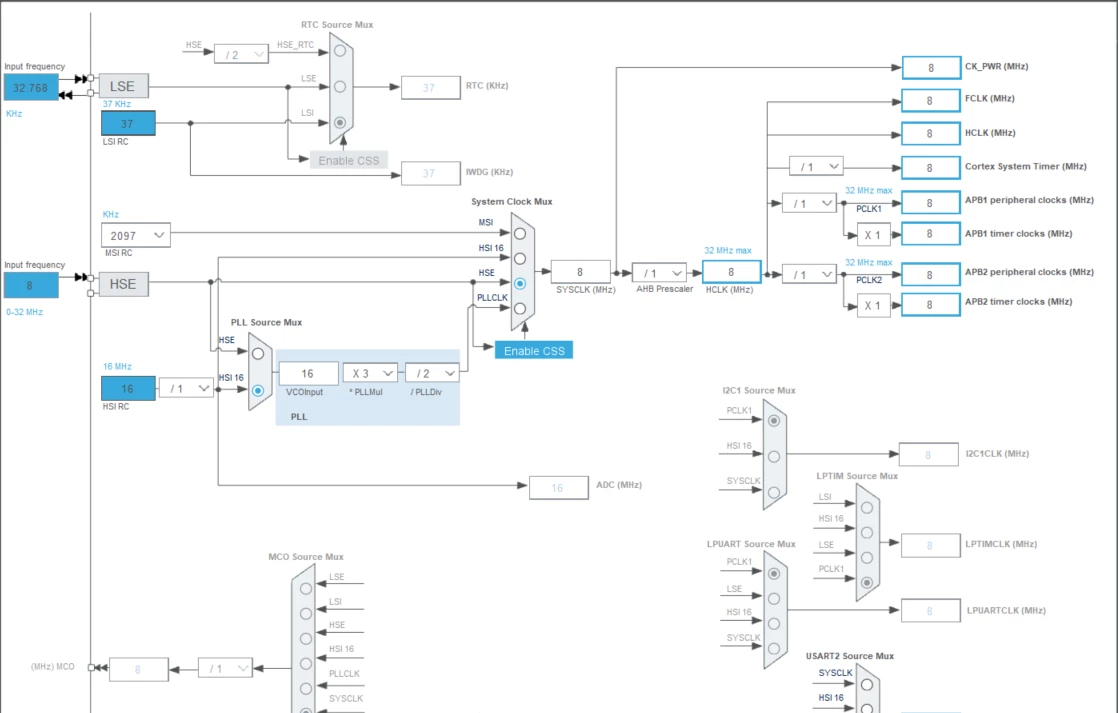

I'm using NUCLEO-L010, tried exact same configuration with another NUCLEO-F303 board and "HAL_UART_Transmit_DMA" works as expected.
Code doesn't stuck or give any error messages during debug.
What did I miss?

Ok, just found the answer.
The order in which modules are initialized matters. DMA initialization followed by USART initialization (I had vice versa). Order can be changed in CubeMX.
static void MX_DMA_Init(void);
static void MX_USART2_UART_Init(void);

What is the return value from HAL_UART_Transmit_DMA?
Might get an example up and running if you're super stuck.
