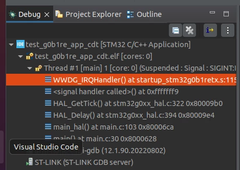

When launching, the sw hangs at startup, with an "unexpected interrupt".
I can bet it is the systick since the value is always 0 before the crash :
Also I called in the app code HAL_SuspendTick, and the crash does not happen anymore.

I have checked where is put the systick handler :
0x0000000008000690 SysTick_Handler

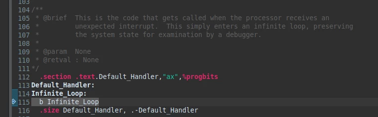

But in fact in the list file I don’t find it at this address but the default handler :
08000690 <ADC_COMP_IRQHandler>:
 * @retval : None
 .section .text.Default_Handler,"ax",%progbits
Default_Handler:
Infinite_Loop:
 b Infinite_Loop
 8000690: e7fe b.n 8000690 <ADC_COMP_IRQHandler>
So during linkink process the Systick_Handler is replaced by the default handler, but why ?

  • Comment in the startup file the weak alias for SysTick_Handler.
So again how can the Systick_Handler be removed during compilation ? How can I avoid that ?
EDIT :
So thanks to chat-GPT I could resolve this by adding the linker option : -Wl,--whole-archive -ltest_stm32_g0b1re_executable -Wl,--no-whole-archive
